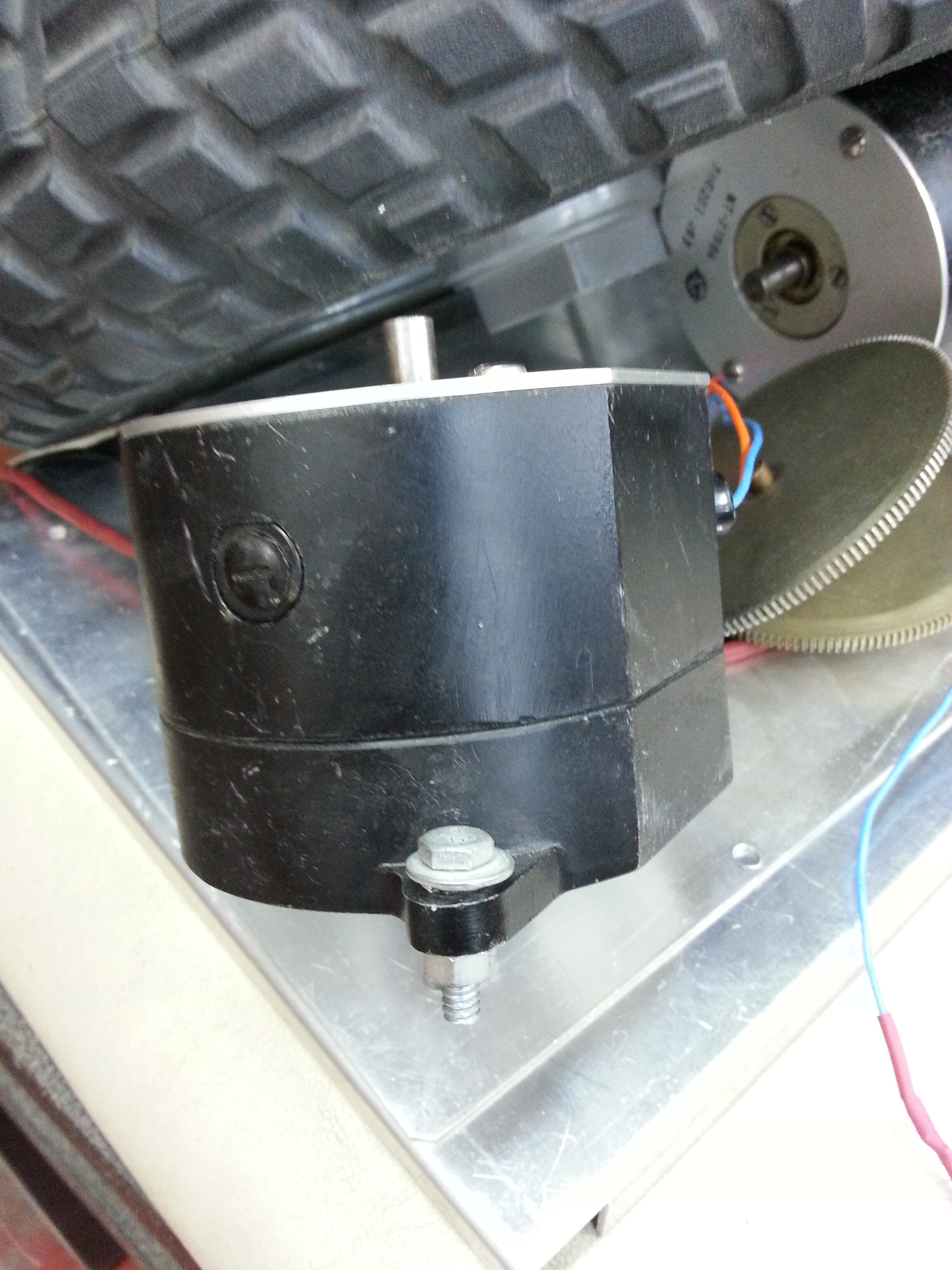

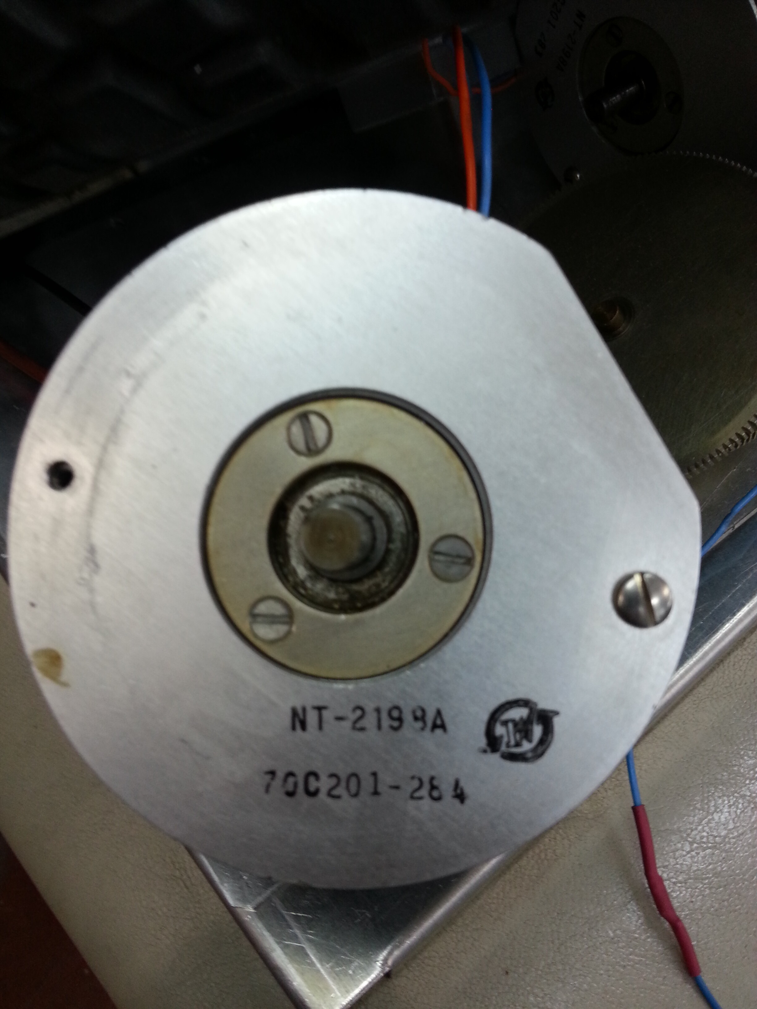

I’m building an arduino controlled two wheeled segway type robot. I’ve stumbled across two DC motors which seem to be ideal for this purpose, the problem is that I don’t have their datasheet and I can’t seem to find their parameters anywhere. I can’t even identify the manufacturer.
I’ve attached a couple of photos of the motor in question. Any help would be greatly appreciated.
No, they are obscure. Seem to be standard brushed PM DC motors. Key parameters are:
motor constant in Nm/A or V/(rad/s) winding resistance max speed
You can measure the first two, but the max speed you'll have to estimate.
If you have a tachometer you can measure the rotation speed for a fixed supply voltage directly, which you can then convert to volts-per-radian-per-second.
This then tells you the newton-metres-per-amp directly, they are the same constant.
A motor of that size will probably go to 3000 or 4000 rpm (300 to 400 rad/s) happily. Given the motor constant that will suggest a convenient operating voltage.
The power dissipation depends mainly on the size, so coupled with the winding resistance will indicate roughly the continuous current it can handle.
Ah, I hoped I could avoid measuring the parameters directly, but no such luck I guess. Thanks for the tips! I'll post if I encounter further problems.
