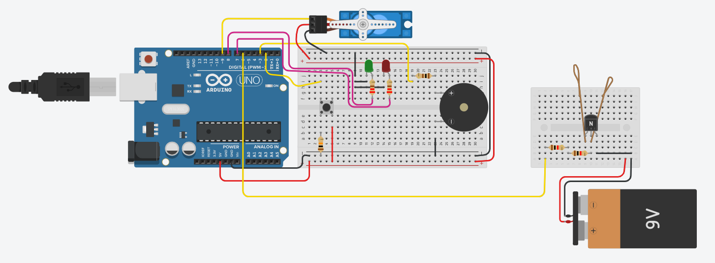

I an making a project using arduino(which is compulsory ).
the project the "Water tank overflow turn off switch ". The project aims to turn of the switch using servo motor (the switch i the same as the fan round switch ).

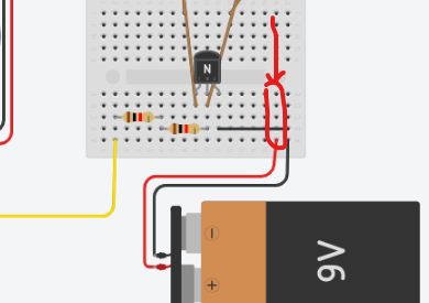

i need help in connecting the BC547 transistor and cant seem to get the circuit right like where the ends of probe go or how the collector and emitter should be attached to the battery.
Since i am using Tinkercad to make the circuit the NP_N transistor is to be replaced by BC547.
(i have attached 2 1K ohm resistors to the transistor )
The only problem i am facing in the connection of transistor and how will the arduino read its signal .
It will never get a signal over just one wire, you need common ground between the two circuits.

First of all, do you know what ground (GND) is? It's very fundamental in electronics, so you should know. Then you just add to yep circuits ground together, and voilà, you got common ground!
But do you really need the 9 V circuit? Why don't you use the 5 V from the Arduino instead? Distance?
Yep, not to also mention the fact the positive from the 9V battery goes nowhere:

this is how it will look

When you stick the probes in water, the voltage at A0 will go from 4.5V to close to zero volts.
Do you understand how to read the schematic?

thankyou this has made the connection easier !

You don't need the transistor , just do an analogRead();
