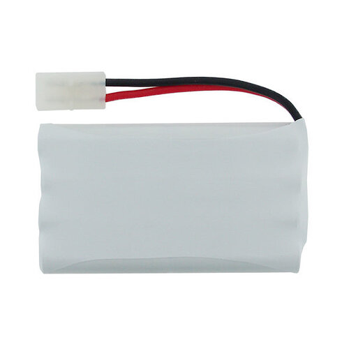

The code works perfectly when using a USB cable.
The problem is that I want to use an external power supply (a 10V battery)
When I try to run the code with the battery, the motor does shit, going one way, then the other, not as I'm asking in the code.....
Has anyone ever had any similar problem?

Yes, when I didn't have things wired properly. How DID you wire the power supply and the servo to the Arduino?

the Servo is a 3 wired basic servo : 5V, GND, command.
5V is connected to the 5V of my Arduino
GND... well to the GND
the command wire is on the second PWM on my Arduino
For the Power Supply, I have attached a jack output to my battery. The jack is implemented in the Arduino Uno
EDIT :
here's my battery :
I checked the voltage level and it's in the Arduino Specs
I will provide photos of my setup if you need some
The Arduino is not intended to power a servo. They suck way too much current.
That's why you got the 10V power supply. It is THAT wiring that matters.

It works like a charm when I connect it on USB to my computer... So I guess the Arduino is able to provide enough current for one single servo
The Arduino is probably being stressed to hell and back, but, hey, you can always get another one when it dies.
When I unplug the USB, the functioning is completely erratic....
The fault is NOT with the Arduino. Whatever is providing the power to the Arduino is NOT up to the task.
Repeat after me: Servos suck a lot of current.
So what should I do? i'm kinda lost right here. I understand I shouldn't use the Arduino to supply current to the servo, so I should use my battery instead?
The battery is 10V, should I pick the 10V and lower it with some voltage divider? ( Only have resistors right here...)
Yes!
The servo won't like 10V, so, yes, you'll need to lower it. Think about HOW a voltage divider accomplishes that task, though. The excess voltage is wasted as heat. The amount of heat depends on the voltage drop AND the current flowing.

When using external supply.... ie battery.... connect the ground of the battery to the ground of arduino.
And if the motor etc can't handle 10V.... then a driver circuit or voltage lowering circuit is needed as well.
