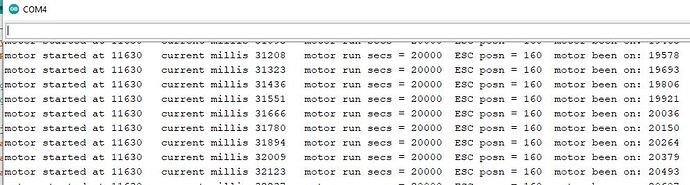

Can you please help me to jump out of a do loop. I'm sure its something very simple, but just can't work this out.
I'm trying to use a do loop and millis to keep a brushless motor running for 20 seconds and then drop to idle. I've spent ages looking the do loop examples because I thought thats where my problem was; now I'm thinking its possibly a problem with the roll over of the millis value and how these need to be handled.

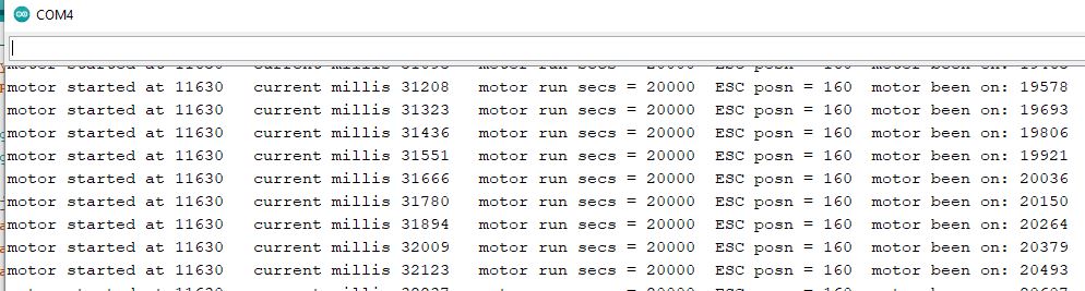

My problem function is "void MotorRun()" in the attached version 22 code "while ((currentMillis - motorStartTime) >= motorTime);" I want it to jump out when the value hits 20036, but it just keeps on running.

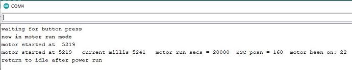

The line of code marked version 20 jumps out of the loop; but after the first loop and not 20 seconds after.
I've included this function below and the full sketch. I'm new to this kind of thing; sorry if its not very well written.
many thanks
Dave

// while (1) // think I need to change this to a doo loop; drop out when motor timer goes above the run time

// return; // trying to jump out of the loop, sure this is not the right way.....
// } while (motorDuration > motorTime); // from version 20 - jumps out of the loop ok but after the first cycle; need it to jump out after 20 seconds
// } while ((currentMillis - motorStartTime)> motorTime); // from version 21 - motor starts up ok but dusn't jump out of the do loop after 20 seconds
} while ((currentMillis - motorStartTime) >= motorTime); // from version 22 - motor starts up ok but dusn't jump out of the do loop after 20 seconds
