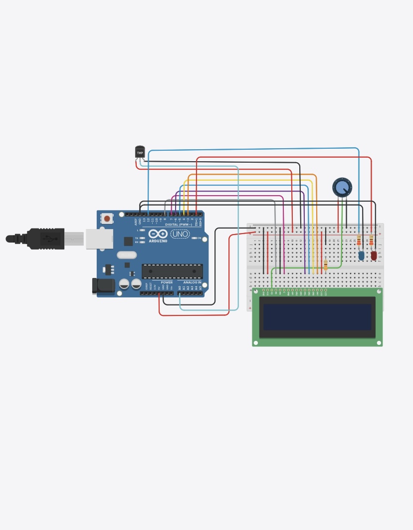

Your schematic is too blurry to read.
If the diagram you show in your edited post #1 is the actual diagram, then you still have the LEDs shorted to 5V.

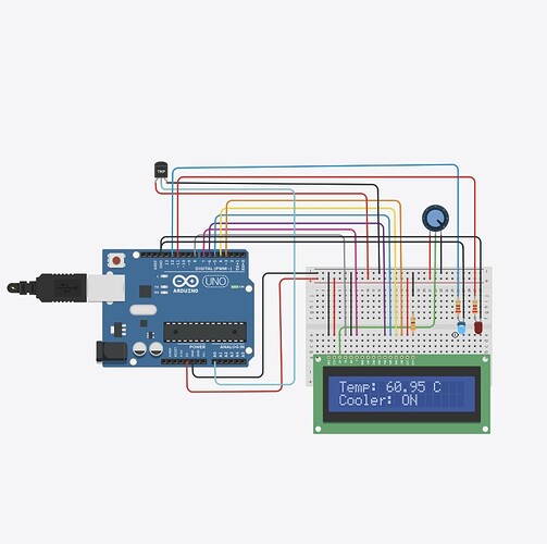

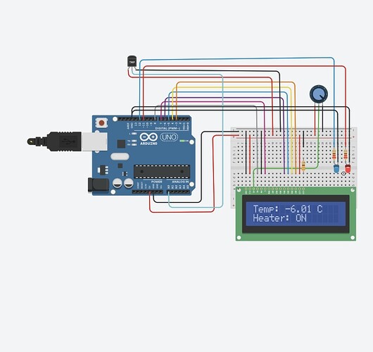

Yes I add the limits which are 20-30
If the temp is under 20 the red will turn on (I add led which is symbol for heater since there is no heater in tinkercad) ,if the temp is above 30 the blue led should turn on(blue led is symbol for cooler since there is no cooler in tinkercad)
Also if the temp is btw 20 to 30 both leds should turn of
Also the temp will be displayed on the lcd

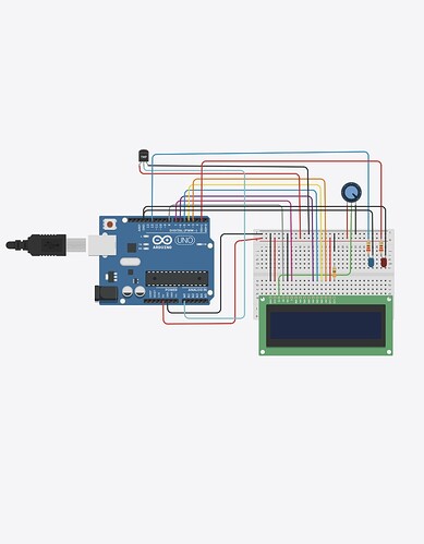

In my circuit the lcd is working but I have a problem where both leds are on eventhough I change the temp
This the circuit

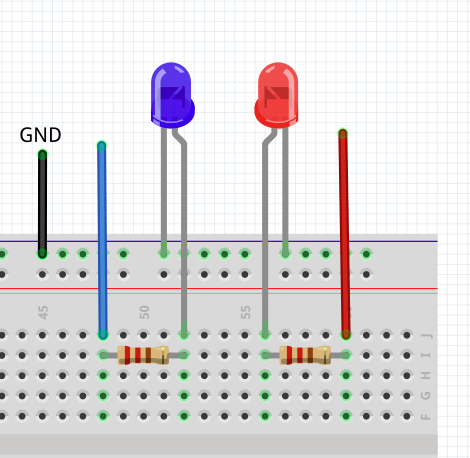

You have the two resistors connected directly to 5V. That is why the are always on.
Move the resistors from the 5V rail connection
As I already mentioned, it's too blurry to read.
Ok I will try that and tell you what will happen
like this
Thank u so muchhh for your help I really appreciate that,I have been trying for a week to find solution the I add it on arduino forrum
Thank u
You did not follow my diagram

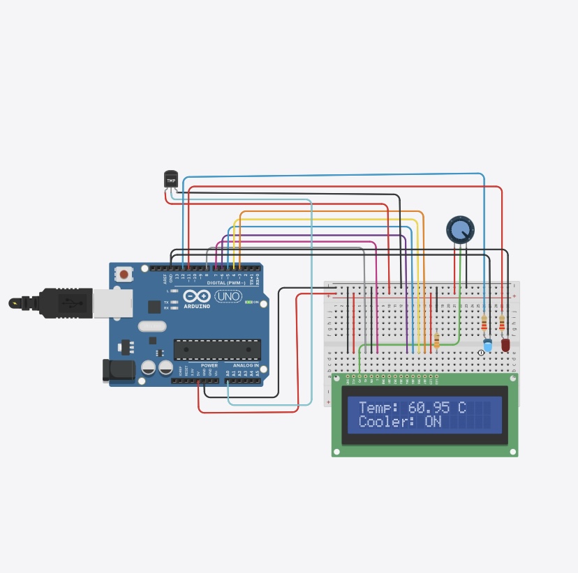

I followed what you said and removed the resistor from 5v and it worked as it should
So anything else?
FYI: Just because it works in the tinkercad simulator does not necessarily mean it will work in a real circuit.
Thank u ,for now I just need it to work on tinkercad

Sorry but I can’t add the link of tincercad here but I already add photos and the code
And photos of how it worked
