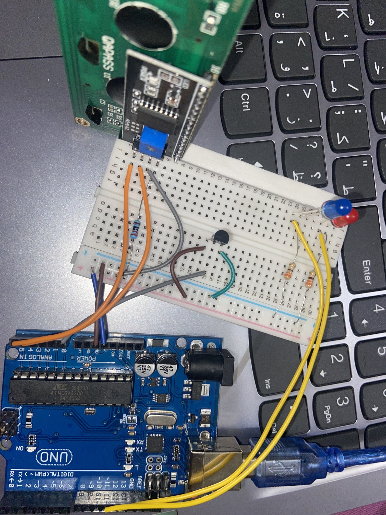

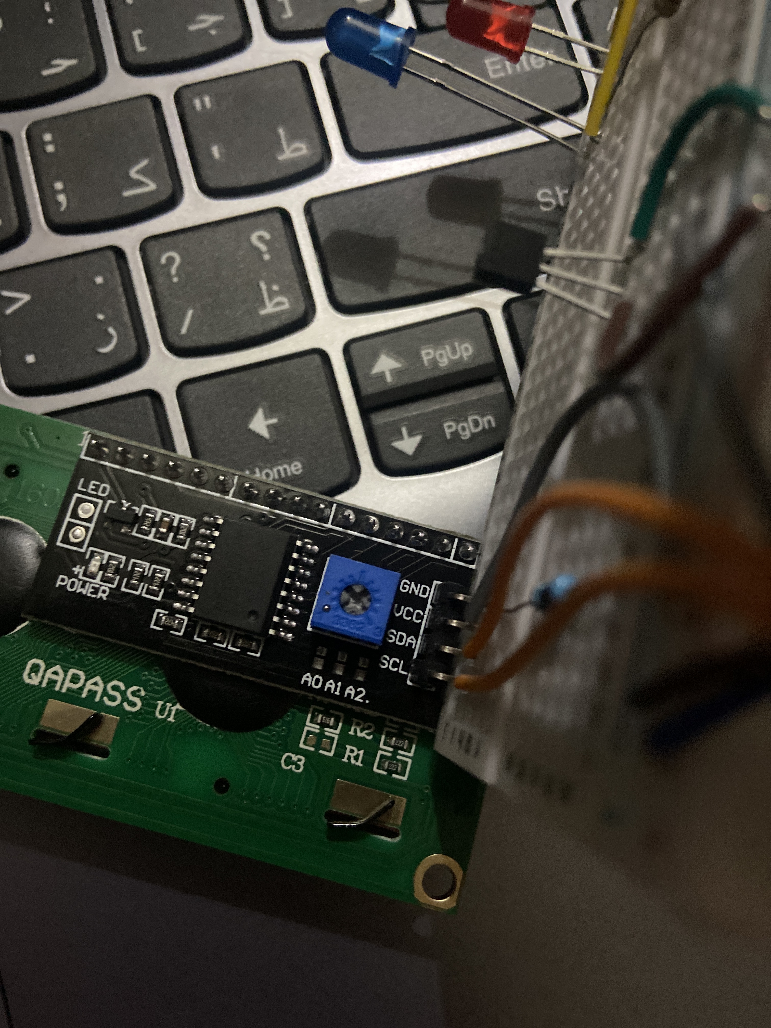

Ok I add the photos and code
  • Why is there a resistor on the LCD display GND lead. :thinking:
Should I remove it
It is my first time of making arduino circuit
  • Replace it with a wire.
Ok I will do this
Thank u it worked I changed the code

I want to ask if it is ok not to put resistor to the lcd screen?
I tried that also so I add a different code
You should not have any resistors connected to the LCD.
Did you get your LCD working?
Yes it worked when I remove the resistor, Thank u.

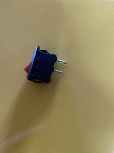

I want to ask something also, can I connect this switch to the arduino board
Also I tried to connect my project with 9V battery but it is not working although it is a new full battery
Of course you can. You would need to either solder wires to it or buy something like below. I say it's time to learn to solder.

Ok thank you so much,unfortunately I don’t have a multimeter but I add the switch by ysing wites and electric tape .

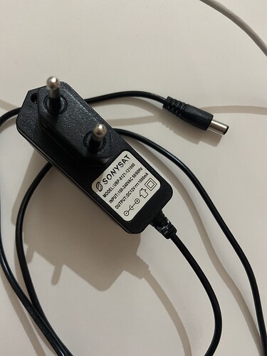

I want to ask you can I use a power supply directly using 12V power charge?
For what you are doing, Yes. That is much better than the battery.
