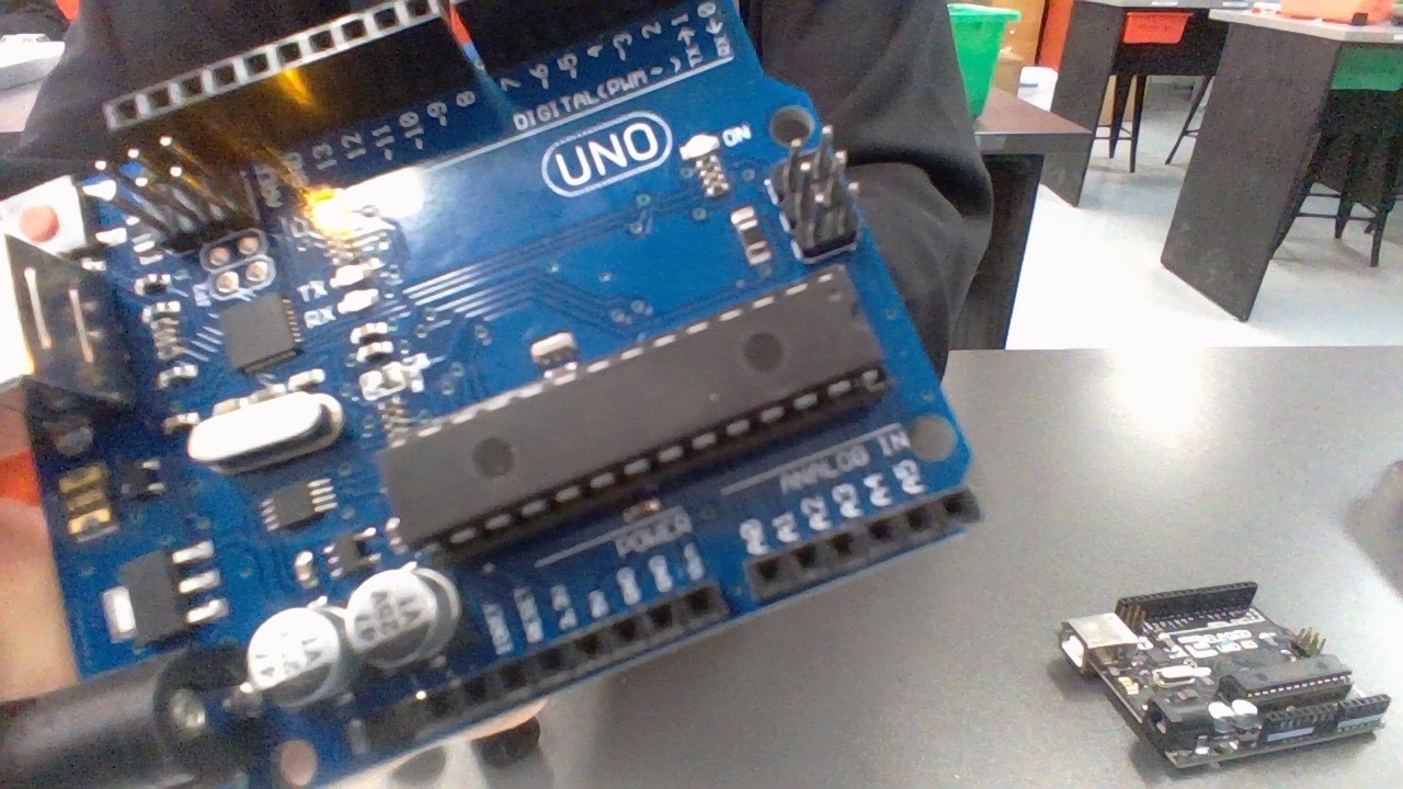

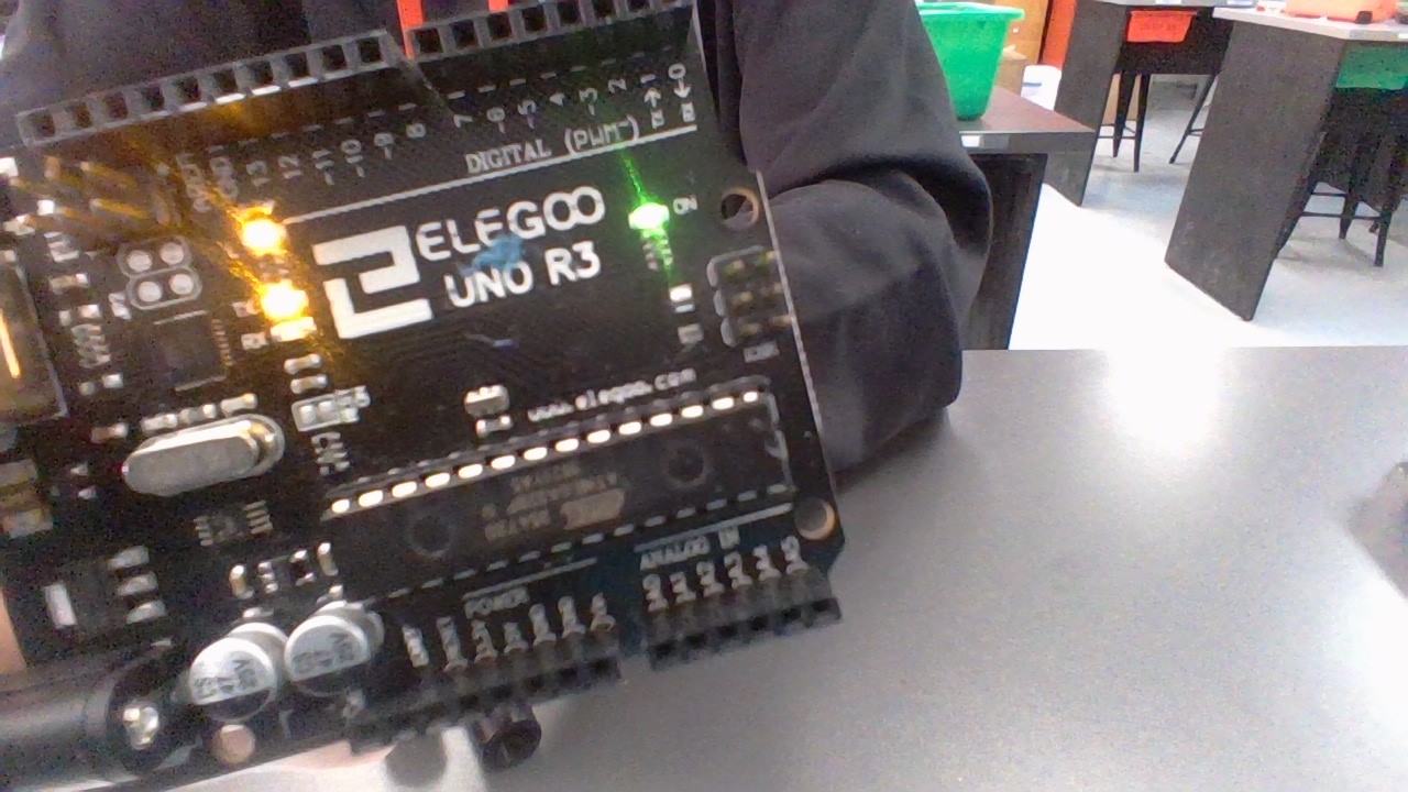

Hello! I tried connecting my board but it just doesn't want to, I am using the blue arduino Uno R3 and I tested with another board, and the other board works, I don't know what to do, the only visible difference is this!

The top board is a clone. Get a magnifying glass and determine what chip is being used for the USB/Serial connection then install that driver.
Op has the "blue" board, and states the top board (Elegoo) works (probably has CH340/341 - that was what I needed for my Elegoo R3). "Blue" board probably is a clone, might have a different comm IC, and maybe the no-labeled 328p has no bootloader.

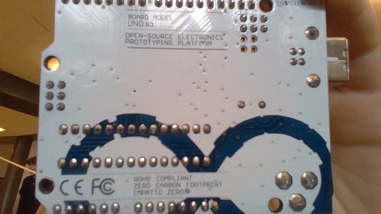

I try to connect it to my chromebook through the usb port using a blue connection cable, but the black board shows me a message of connection when I plug it in, not the blue one, the blue one is the one I used for the past year, and it was working FINE until a week ago, I tried everything, so I came here to get maybe answers, the blue board has a white "belly":
and the black board, a black "belly":
both board are using ATMEL ATMEGA328P and ATMEGA16U2 chips

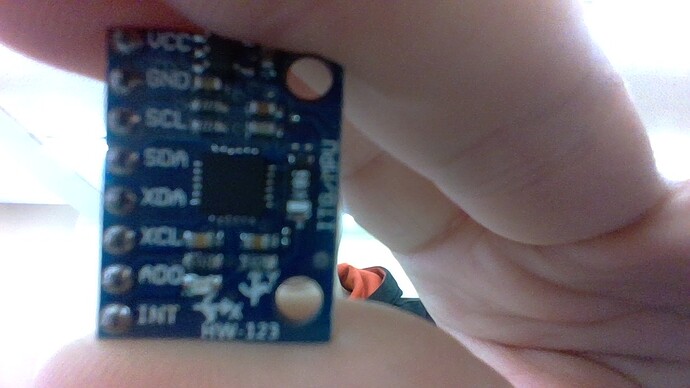

OH MY GOD I KNOW! I tried to plug in this fudger, a gyro+accelerometer, I think maybe that could have been the thing that fried it, its the last thing I remember plugging in my arduino
It's unlikely that it was the sensor itself. Maybe reversed cables or even trying to connect something with the Uno powered on.
