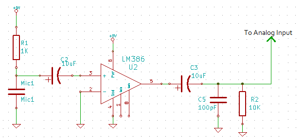

I have a circuit (electret mic + opamp) whose voltage output will sit at 0V until it hears a sound. You can clap, or make noise and the voltage will increase proportional to the noise level. I've been experimenting with it as a sound trigger. It can pick up a pin drop. If you're interested I can post the diagram.

Here's the circuit I use. Like I said, I'm experimenting with it as a sound trigger. Mic1 is just a generic electret mic I got off ebay. Be sure you get the polarity correct. C5 and R2 provide an envelope follower (basically how long the output stays high before it drops off). With the values quoted, it the output will drop off fairly fast, I'm guessing around 0.1 sec.
Increasing C3 will have the effect of more amplification (i.e. you will get a higher output voltage).
If you need serious amplification, connect a 10uF cap between pins 1 and 8 of the opamp. I found doing so will increase the noise of the output, but if you need to catch a the sound of a cat purring in the next room it would be worth a shot.
Run the output to an analog input. With a loud clap, you should see the analogRead values spike in the 350-400 range

It is not really a very suitable chip to use as a microphone pre amp, it is basically a power amplifier with a limited gain.
You would be much better off using a proper op-amp.
C3 does not increase the gain, it just increases the coupling, the gain is controlled by a capacitor between pins 1 & 8.
