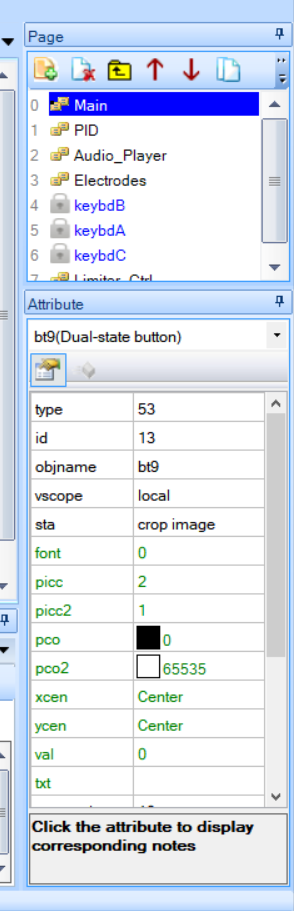

I am trying to simulate a LED to change color from Green to Red by using a Dual-state button (bt9) in Nextion configured with "crop images". The crop images (LED) change from picc=2 to picc2=1 depending of the Dual button state.

Here is a screenshot of the Dual-button attribute:

To toggle between the two crop images set by the Dual State button try this syntax with EasyNextionLibrary.
I'm not exactly certain which of the crop images will show with each value.
myNex.writeNum("bt9.val", 0);
myNex.writeNum("bt9.val", 1);
Thanks, that worked...
