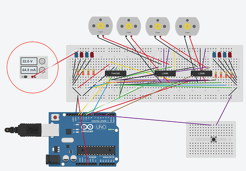

Look at the attached sketch of the project I am currently working on. It is a circuit that controls 4 different magnets (in the image they are shown as motors, but they should be magnets). As you can notice, the power supply for the magnets (circled in red on the left side) is completely separate from the Arduino which is just taking care of the shift register on the left (74HC595). I want to keep the two circuits separate because of the magnets need something like 32V and between 500ma and 1amp of current. The 4 magnets are driven by two L293D.
Now, the problem I am trying to solve is that even when the Arduino is not giving the command to power the magnets (via the push button), I see the L293D and the magnets drawing some power from the power supply (something like <=200ma), not much, but sufficiently to heat the L293Ds even when they are doing nothing. I'd like to find a way to stop the power supply when not needed (i.e. when the switch button is not pushed).
I have thought to use either a relay or a mosfet transistor to control the power supply to the breadboard, but that'd imply having common ground with the Arduino circuit which I would like to avoid (I tried to have common ground with the Arduino and I fried a couple of shift registers because of that!)
Am I seeing this completely wrong? Or do you have any suggestions?

It is nearly impossible to interpret that Fritzing diagram. They are a terrible waste of everyone's time.
Please post a hand drawn schematic of the basic circuit (for just one magnet).
You should be able to turn the magnet on and off completely with the L293D, so get that basic one magnet circuit working before putting the rest of it together.

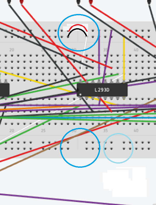

Verify that there's a connection between the power rails indicated by the blue circles. On many breadboards these have to be jumpered manually - as opposed to the smaller gap indicated by the smaller light blue circle.
Can anyone tell me if there is a common ground in that pic.
Really hard to tell from here.

I'll upload a simplified schematics with less components soon. Thanks for your feedback.

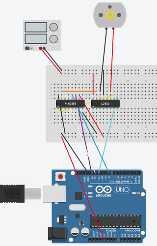

Ok, look at the image below, it is simplified and everyone should be able to understand it. As you can see, the power given to the motor is completely independent by the power given to the shift register:
I am also attaching the same image if you need a higher resolution.
Eager to know your thoughts. Thanks.
Hand drawn schematic diagrams, with IC pins labeled according to function, are much more useful, and waste less of your and our time. Please do not post any more Fritzings.
But it is obvious that the connections to the L293D are wrong. For one, there is no common ground between the motor driver and the Arduino. What is the 595 IC supposed to do?
Finally, breadboard tracks burn if subjected to motor currents. Breadboards are for logic circuitry only.

Second, the circuit works and the motor turns even if there is no common ground between the L293d and the Arduino because the shift register is driving the L293D. The breadboard I am using is rated 5amp. The 595 IC is supposed to drive 2 L293D for 4 magnets as described in my first post above.

If the circuit works, your circuit diagram is wrong.
You are asking for help, from volunteers. If you don't want to provide the information required to help you, post on another forum and don't waste our time.

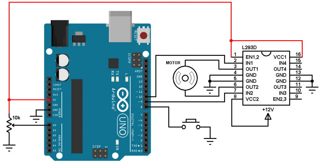

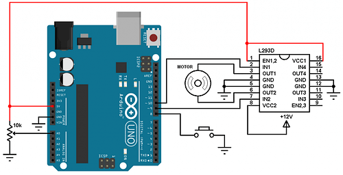

This is an example of a useful and correct schematic or wiring diagram for a motor and L293D. Notice the required common ground.

Actually the post number 8 by jremington should really answer your question and help you.
Just read the diagram carefully and apply it to your circuit.
You really need that common GND.
