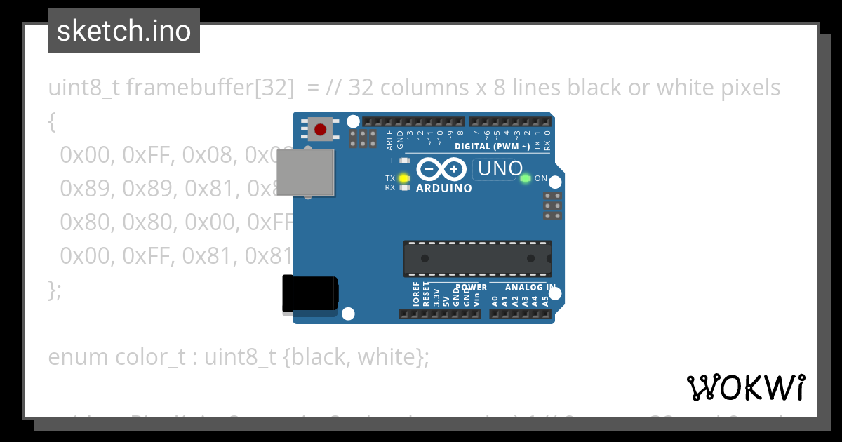

here is a more involved example
you should see in the Serial monitor
the code for reference
uint8_t framebuffer[32]  = // 32 columns x 8 lines black or white pixels
  0x00, 0xFF, 0x08, 0x08, 0x08, 0xFF, 0x00, 0xFF,
  0x89, 0x89, 0x81, 0x81, 0x00, 0xFF, 0x80, 0x80,
  0x80, 0x80, 0x00, 0xFF, 0x80, 0x80, 0x80, 0x80,
  0x00, 0xFF, 0x81, 0x81, 0x81, 0xFF, 0x00, 0xBF,
enum color_t : uint8_t {black, white};
void setPixel(uint8_t c, uint8_t l, color_t color) { // 0 <= c < 32 and 0 <= l < 8
  switch (color) {
    case black: // write a 0 in the corresponding bit
      bitSet(framebuffer[c], l); // https://www.arduino.cc/reference/tr/language/functions/bits-and-bytes/bitset/
    case white: // write a 1 in the corresponding bit
      bitClear(framebuffer[c], l); // https://www.arduino.cc/reference/tr/language/functions/bits-and-bytes/bitclear/
color_t readPixel(uint8_t c, uint8_t l) { // 0 <= c < 32 and 0 <= l < 8
  return (bitRead(framebuffer[c], l) == 1) ? white : black;
void printScreen() {
  Serial.println("------------------------------------");
  for (uint8_t l = 0; l < 8; l++) {
        Serial.print("| ");
    for (uint8_t c = 0; c < 32; c++) {
      Serial.write(readPixel(c, l) == white ? '*' : ' ');
    Serial.println(" |");
  Serial.println("-----------------------------------\n");
  printScreen(); // will show our initial Hello pattern
  // remove the '!' at the end
  for (uint8_t l = 0; l < 8; l++) setPixel(31, l, white);
  printScreen();
  // clear up the screen (pixel by pixel)
      setPixel(c, l, white);
  printScreen();
  // fill up the screen (pixel by pixel)
      setPixel(c, l, black);
  printScreen();
void loop() {}
