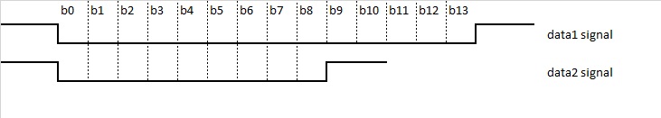

I am receiving the following signals on Pin 2 on an Arduino Uno,
In the picture attached b0-b8 in data signal2 can be either 1's or zeros. all bits in data signal1 are zeros.
I have written the following code to capture and output to serial monitor:

the output seem to be ok for the first few data picked up but after that it got completely random which I suspect is because the timings to read the data is drifting.
As the bit reads are time critical, I would be grateful if anyone could help out with fine tuning the timings.
I have already set the complier to optimise code for speed (O3)
the code should be able to work for a frequecy range of 9-21khz
Logic failure! I see you are expecting 9 bits, the first being a start bit. Then 8 data bits. All normal. Then you expect an interrupt on the next bit going low to be another start bit. But I don't see where you include a "stop" bit, always high, so you have 10 bits per data character.
So, are you getting out of time after the first 9 bits?

you are right Robin,
I am trying to write a modified version of SoftwareSerial but am struggling with getting a working code that would reliably detect data signal1 (which by the way can be more than 14 bits long) hence my posting here for help on improving my code.
And thank you for pointing me on how to inline images - I was wondering how to do that! :slight_smile:

How do you know the BREAK duration? You should use an oscilloscope or logic analyzer to verify the timing. You could also write a sketch to display the min and max LOW times that are greater than 10 bit times.
The sketch I provided should absolutely work if it is connected correctly and the MIN_BREAK_TIME is set correctly.
