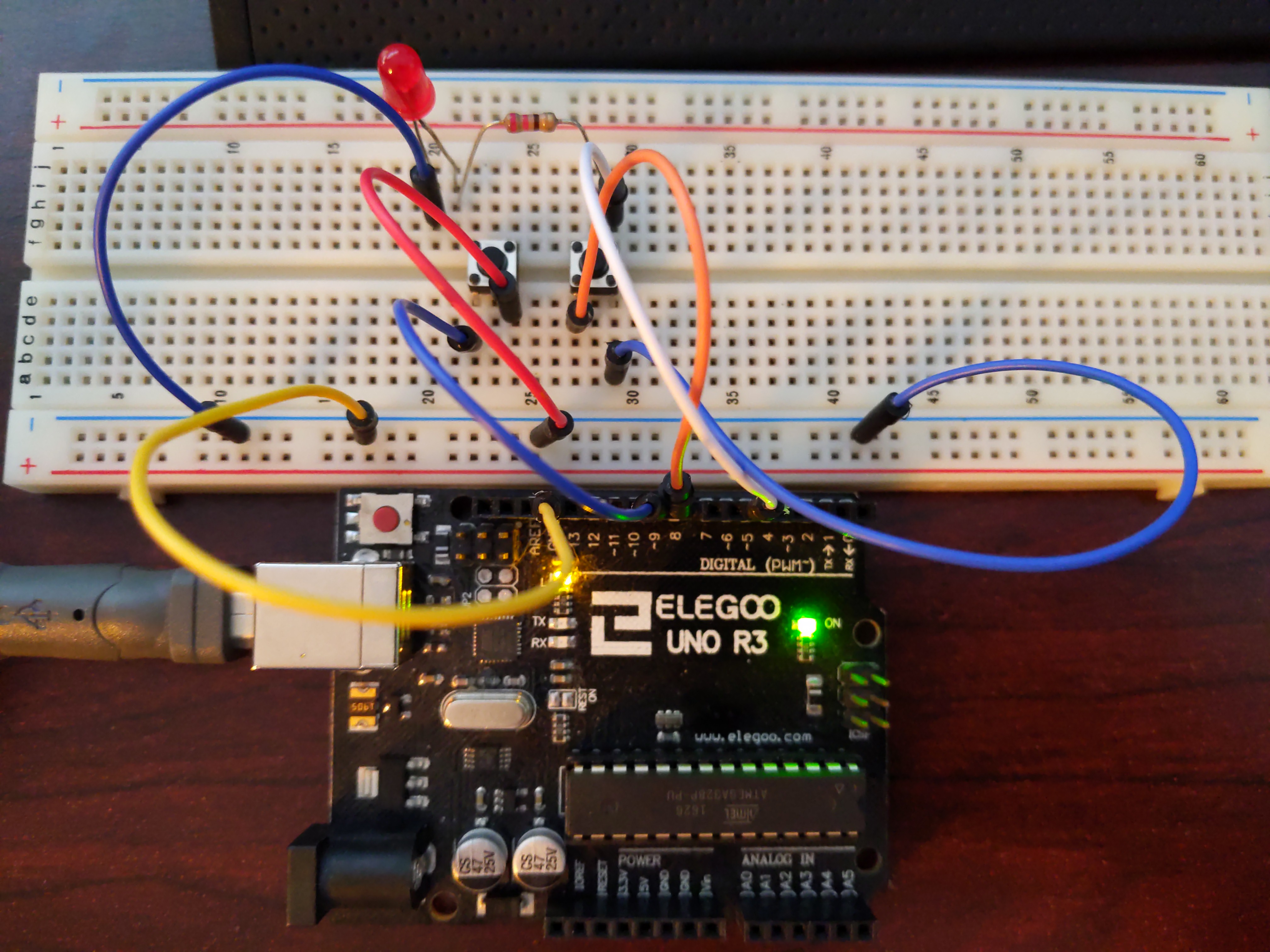

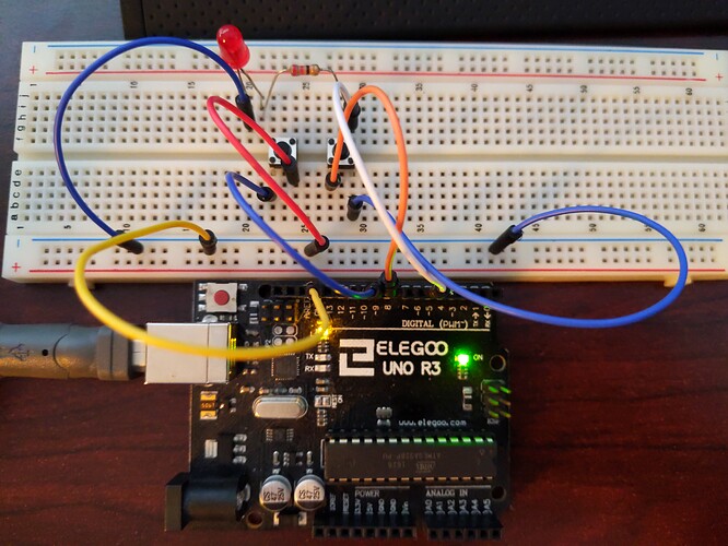

When I press the left button, the LED will not turn on. I've tried replacing the LED, but yet, nothing happens.

Do you have the flat side of the LED going to GND ?
Looks like you might have the right switch interfering with the LED cct.
Let’s see the schematic.

Yes, I do.
Use diagonal corners with those switches.
Which diagonal corners do I want to use? Their diagram shows it the way I have it configured.

It doesn’t matter, just use opposite corners.
Is the ‘right switch’ interfering in the LED wiring ?

Is the yellow jumper connected to gnd on the controller, hard to see in the picture.

If you take the link out of D5 and connect it to +5V does the LED light?
If you put it back and write a "1" to D5 does the LED light?
You appear to have the 220 Ohm resistor and white wire connected to the ground terminal of the right hand button. :astonished:
Doh! Thank you. That fixed it!
