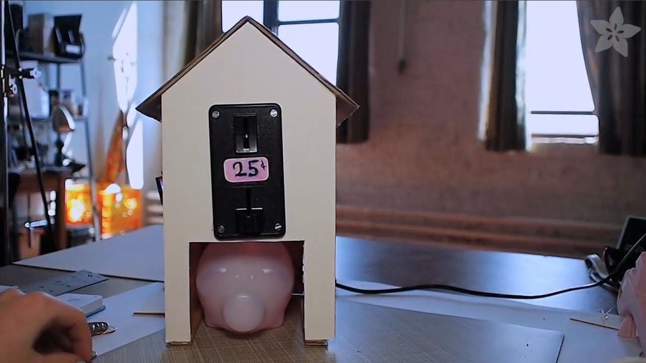

i was looking at adafruit's piggy bank..
a couple of things:
1.) i don't need the led she is using, so that i can remove from the code.
2.) i don't know why she is using a shield - it was not mentioned in the parts list...
3.) i want to save the the dollar amt say if the power goes out.. or i unplug the unit or batteries die - not sure how i want to power this thing yet..
4.) i want to make this a stand-alone, meaning i don't want to have my arduino attached to it
what will i need or how do i go about accomplishing steps 3 & 4?
basically i would like to make an enclosure as she did.. but to sit on top of say a large collecting container like:
The LCD is attached to it.

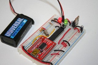

basically that's what i want to do.. build a simple arduino on a perfboard.. just enough to run this as a standalone..
say a 9v wall power supply, power jack for the power supply, lcd display.. and as you said an atmega chip..
after that i really don't know what else i need to put on the perfboard.. i never built an arduino.. hell, i'm new to it all..

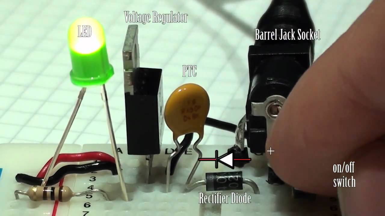

You'll need a regulator. You can not rely on that power supply outputting exactly 5V. That will require resistors and capacitors.
There are plenty of schematics and how-to guides on line for building a standalone Arduino. Though, by the time you get done, you probably won't have saved any money.

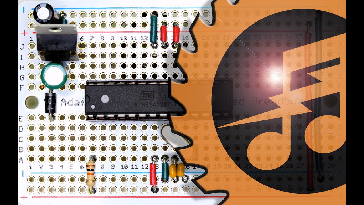

all the "tutorials" i find are either usb or battery pack based.. ex:
i haven't found one that is for a wall power supply as of yet.. and on an perfboard instead of a breadboard.
well, there's this one, but has parts on there i don't think i'll need for this project - (ie: pin headers and everything that has to do with them)

7805 voltage regulator gives constant 5v
7809 voltage regulator gives constant 9v
7812 voltage regulator gives constant 12v
Try..
http://nathan.chantrell.net/20110819/build-your-own-arduino-for-under-10/
http://www.paulinthelab.com/2012/04/arduino-veroboard.html

i just found this vid..
and this one..
gonna watch them now..
@Tom
ty for the links.. much appreciated
i liked the first one the most i think.. although it does talk about the voltage regulator, they skipped a part by not putting in the power jack on there as well.. we can skip the usb because there is absolutely no need for that part.. it's strictly wall jack powered

Second, as for a power supply, you will probably want to use 5V (five volts). Depending on the kind of power supply, you might need to do a bit of soldering to wire it up correctly. (I found this out the hard way, with much aggravation.) That is because you will not be using a "proper" Arduino, which brings me to...
Third, there exists an Adafruit-branded thing called a "Boarduino". I have successfully used Boarduinos in clock projects I have built. I strongly suggest you cough up the dough for the USB version of the Boarduino (your sanity is worth the extra $7.50). Actually, if you use USB power, you don't need to worry about the extra soldering for the power supply or the related aggravation, but then you need a proper USB power supply and not just any old 5V power supply.

Be careful with voltage.
Is always correct, but here:
you could as well read "7-12VDC" next to the 7805 Input (VIN) and use a 12V wallwart.
If you do not power too much from the 5V, besides the atmega328p.
Depending on the electrical noise your coin checker might produce on the 12V supply, an additional 100nF ceramic capacitor might help.

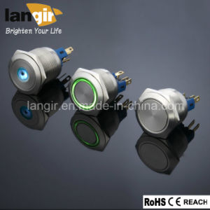

and i may possibly want to add a power on/off switch: Voltage: 5V/12V
http://www.ebay.com/itm/1-Round-Lit-Illuminated-Arcade-Video-Game-Push-Button-Switch-LED-Light-5V-12V-/381264227924?var=&hash=item58c51e6e54
1'' Round Lit Illuminated Arcade Video Game Push Button Switch LED Light
One reason I suggested you finish one project first is to give you an idea of what is realistic and what is not.
The switch you linked to probably would not make sense as an on/off switch for your project. This is because the switch is "on" only as long as your finger is on the button: as soon as you let go of the button, it turns "off".
Perhaps, though, you only want the switch to control power to the lights, display, and coin mechanism. In that case, you could have the Arduino detect when the button is pressed, and send a signal to a relay of some sort to turn on power to the rest of the electronics. However, the Arduino itself would need to already be on in order to detect that you have pressed the button; in other words, you cannot use the button to turn on the Arduino. (Or maybe you can, but setting things up to work that way might prove very impractical.)
maybe not that particular button, but something nice. lit up when on and not lit up when off. could even be a simple looking one like this..
just because someone plugs it into the wall doesn't mean it should be "on".. you plug it into the wall and turn it on by button.. (that's considering if you have an on/off button). otherwise yes, it will be on the minute you plug it in the wall.. always on until power goes out or it's unpluged.
but i was just basically giving out the of parts and their voltage needed - so it can be powered and regulated properly..
