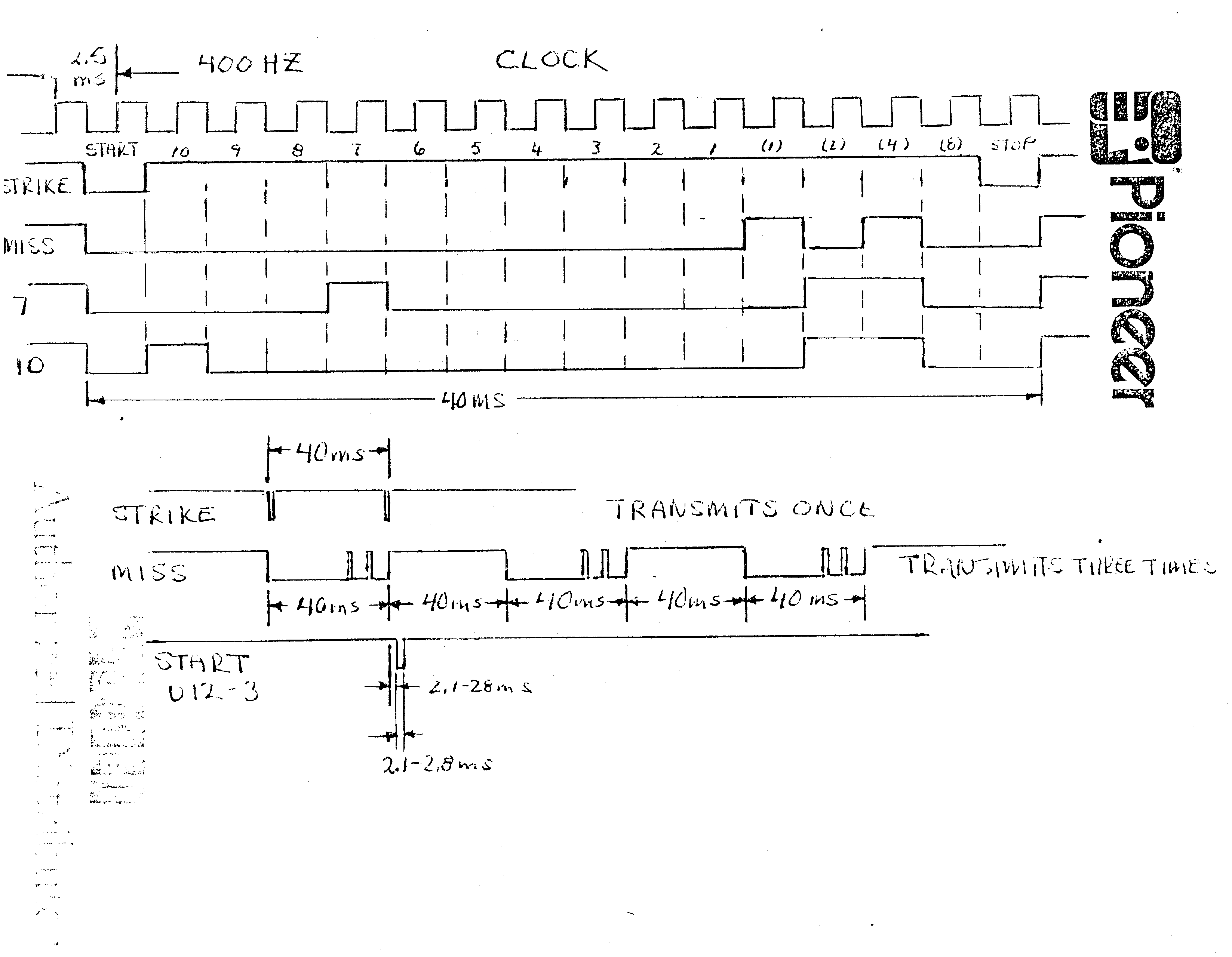

The picture:
The clock can go to a interrupt for the rising edge.
Read the signal in the interrupt.
There is not enough information to say for sure what the start and stop is.
400 Hz divided by 16 bits is the timing frame of 40ms.
Is known what the code is for the specific things ? Is there a list for that ?
It could be compatible with some kind of standard bus signal, but I think that reading the data in a interrupt is the easiest and most flexible way.
Cool signal--each bowling pin has its own bit.
Yes, read data on the rising edge of clock, and fill up an array or word with the bits.

To make things clearer I have added some marks and numbers to the picture
It seems that changes low-HIGH on the dataline start with falling edges of the clock-signal.
before start the dataline is HIGH.
On start the dataline goes low on a falling edge of the clock-signal
if datasignal rises low-HIGH on one of the next 1 to 10 falling edges of the clock-signal this is a pin
If the datasignal stays HIGH for falling-edge 11 to 15 this is a strike
If the datasignal goes HIGH for falling-edge 11
goes low on falling-edge 12
goes HIGH at falling-edge 13
goes low on falling-edge 14
this is a miss
if dataline stays low at falling-edge 11
dataline goes HIGH on falling-edge 12
dataline stays HIGH on falling edge 13
dataline goes low on falling edge 14
this is indicating some pins are fallen

The OP must implement something like "software serial" which read 16 bit words (and STOP is zero) on multiple lines with a baud rate 400.
In short wait for falling edge on all lines and start sampling 3.75 ms later first bit and each additional after 2.5 ms from the previous.
Sample the data on each rising edge of the clock. The first LOW bit is the start signal. The next 10 bits are HIGH if the pin is down and LOW if the pin is present. The next 4 bits are reverse, inverse number of pins standing:
1111 = 0x0F = 0 standing (strike)
0111 = 0x07 = 1 standing
1011 = 0x0B = 2 standing
0011 = 0x03 = 3 standing
1101 = 0x0D = 4 standing
0101 = 0x05 = 5 standing
1001 = 0x09 = 6 standing
0001 = 0x01 = 7 standing
1110 = 0x0E = 8 standing
0110 = 0x06 = 9 standing
1010 = 0x0A = 10 standing (miss)
const byte PinsPresent[16] =
  { -1, 7, -1, 3, -1, 5, 9, 1,
    -1, 6, 10, 2, -1, 4, 8, 0};
The last of the 16 bits is LOW.
Then there is a 16 bit-time (40 ms) HIGH until the next Start Bit.

Andy you provided the right information: the timing-diagram and asked for the basics.
This is what makes all the difference.
Now you have a spot-on customised tutorial to understand clock-signals.

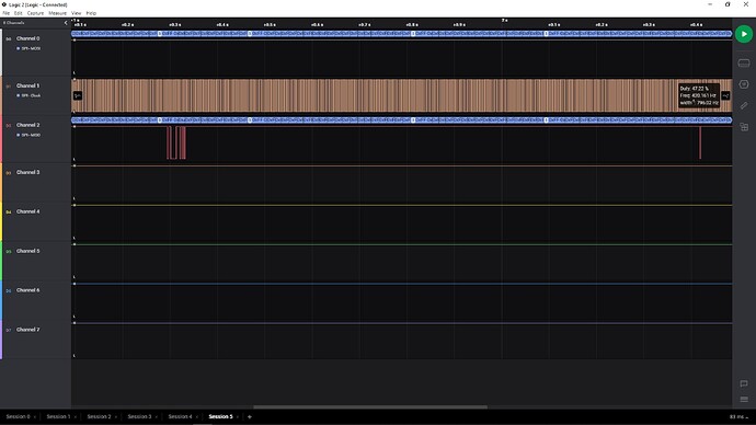

Quick update, I was able to get the analyzer to work, below are the pics.
The oscilloscope picture shows the clock is inverted from the one in the diagram. Change:
void ClockRisingISR()
to
void ClockFallingISR()
and
attachInterrupt(digitalPinToInterrupt(ClockPin), ClockRisingISR, RISING);
to:
attachInterrupt(digitalPinToInterrupt(ClockPin), ClockFallingISR, FALLING);
FYI, the oscilloscope shows:
0: Start Bit
1100000111: Pins 8, 7, 6, 5, and 4 are standing
0101: (inverted & reversed: 0101) Five pins standing
0: Stop bit
