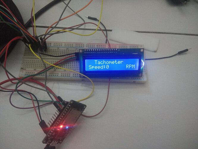

Help! Rpm Speed Sensor does not read
Hi guys, I am learning to make a temperature and rpm monitoring project on an electric motor with esp32, and the program code is all done separately. but when the code is combined, the rpm sensor doesn't work or 0 while the temperature is working. Please help me guys. sorry my english is bad. Thanks

Welcome to the forum.
I have given you a karma as you have posted you code in code tags, thankyou.
So the tacho code works on its own?
You need to have the "count" as a function written outside the void loop();
See this reference;
~~https://www.arduino.cc/reference/en/language/functions/external-interrupts/attachinterrupt/~~
Thanks.. Tom.. :slight_smile:
You better use interrupts() and noInterrupts() for reading volatile variables. As long as you only read a byte, interrupts can be allowed to continue. A 2.5 second delay with interrupts off is not a good idea, in detail if you set timeold before the delay(2500). During that time no pulses can be counted.
noInterrupts(); //can be omitted
temppulses = pulses;
pulses = 0;
temptime = millis();
interrupts();
rpm = ...
timeold = temptime;
