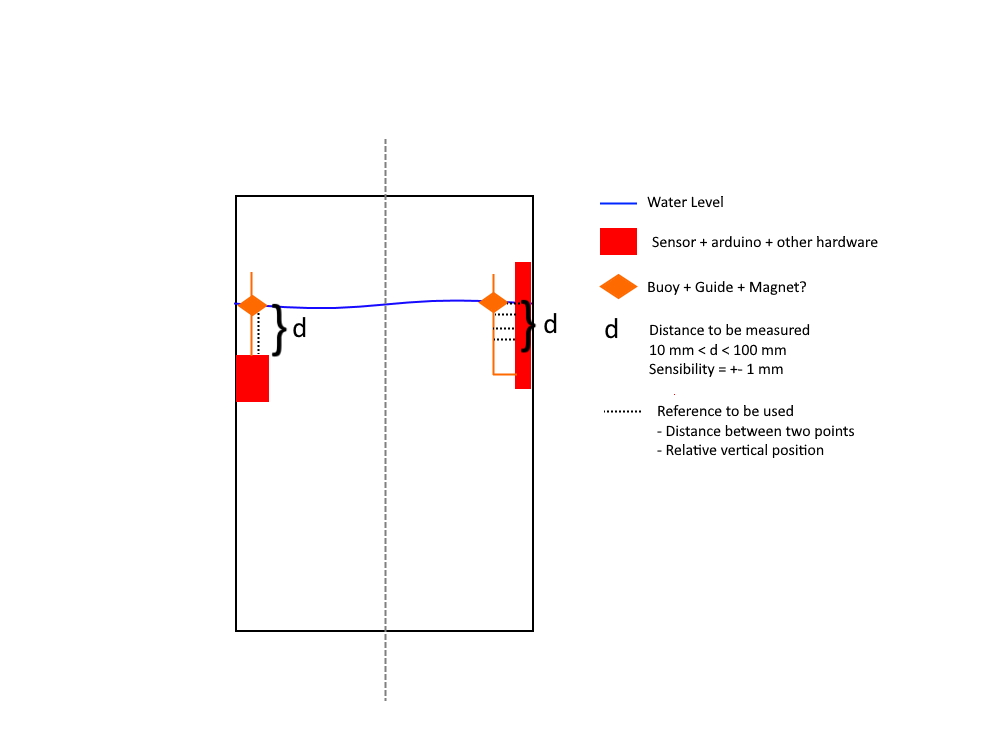

I have been working on an arduino project to measure short distance underwater. My first goal is to measure the liquid level on the tank, but my final goal is to measure density of the liquid using a slightly different set-up. For that reason, I have to inform that I understand that there are other means to measure liquid level, but I am foccused on this set-up.
What I do need is some help to select sensors that can help me to achieve that.
I have made a drawing to try and explain the two different set-ups I have in mind, so you can look the attached figure to see it.
In summary, the set-up consists of a buoy that will float vertically according to the liquid level, being guided by a small shaft to maintain its horizontal position. The sensor will be in a water-tight box in a fixed position.
The first set up (left on the figure) is the one I am more comfortable with, where the buoy will float vertically, and the difference in position will be measured by the fixed-point sensor. I am thinking a linear hall sensor.
The second set-up (right on the figure) consists of the buoy floating vertically, but the sensor is some sort of capacitance sensor, where the vertical position of the buoy will be detected by the vertical sensor.
So, speaking of actual numbers here. I need to measure between 10 mm and 100 mm, but these I can actually try to optimize for shorter range (possibly between 10 and 50 mm will be OK). The important part is the sensibility, that needs to be at least 1 mm.

I don't think any of those ideas are workable.
A linear Hall sensor would give reasonably accurate measurements only in a linear gradient magnetic field, which is probably impossible to produce in that situation.
Underwater ultrasonic transducers are expensive and require specialized, high voltage electronics. I've never heard of one for short ranges.
Laser distance sensors would be a possibility, but must be rated for long term immersion in water.

Thanks @jremington! From what I read on linear hall sensors, people got results on distance measurement using a magnet and a hall sensor, but I could not find many info on how accurate that was (probably not that accurate).

What I came across recently and forgot to mention is to use a digital caliper to measure the relative distance. I will buy one and try to figure out if I can make the ruler/sensor to work from distance to each other (2-5 mm just to get rid of the friction) and if the measurements can handle some "bouncing" of the ruler.
