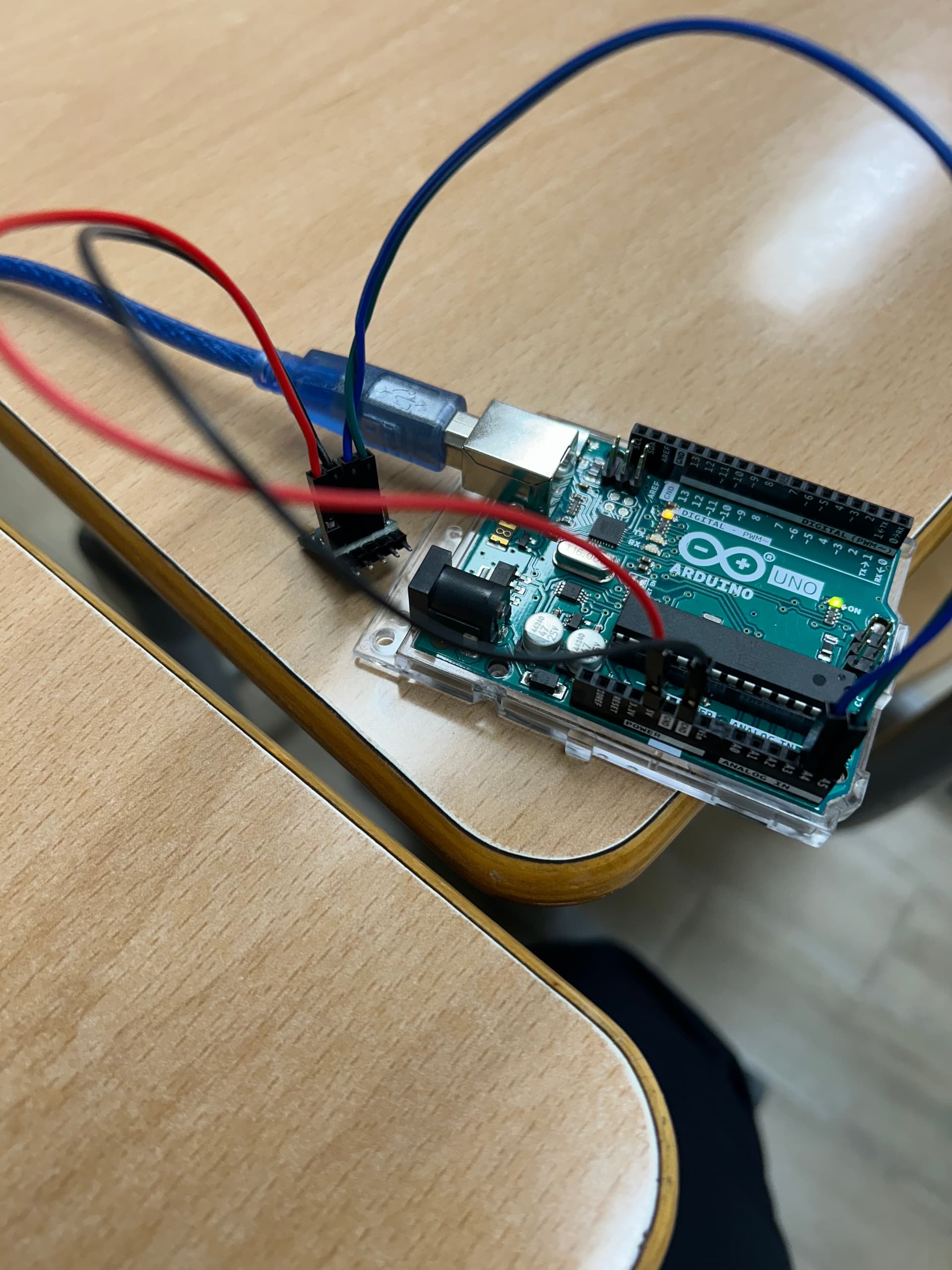

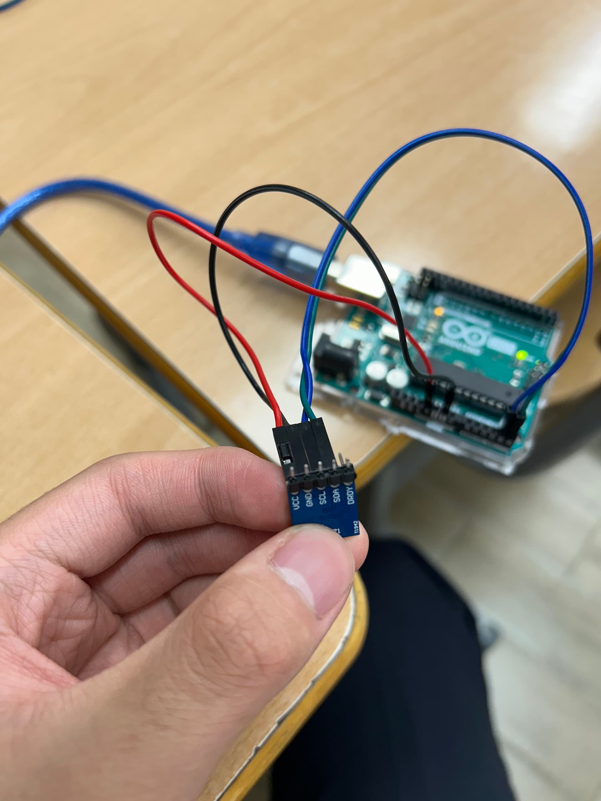

I'm one week into arduino and I don't know what is the problem. Help please.

Looks like you have SDA and SCL cables inverted. SDA (green cable) must be connected to A4 and SCL (blue cable) must be connected to A5.
For one thing that header isn't soldered, so you'll never get reliable contacts across all 4 lines. That's a great way to destroy the sensor.

The odds are against you for that being a good sensor, the loose connections because of the un-soldered header can damage or destroy your sensor.
