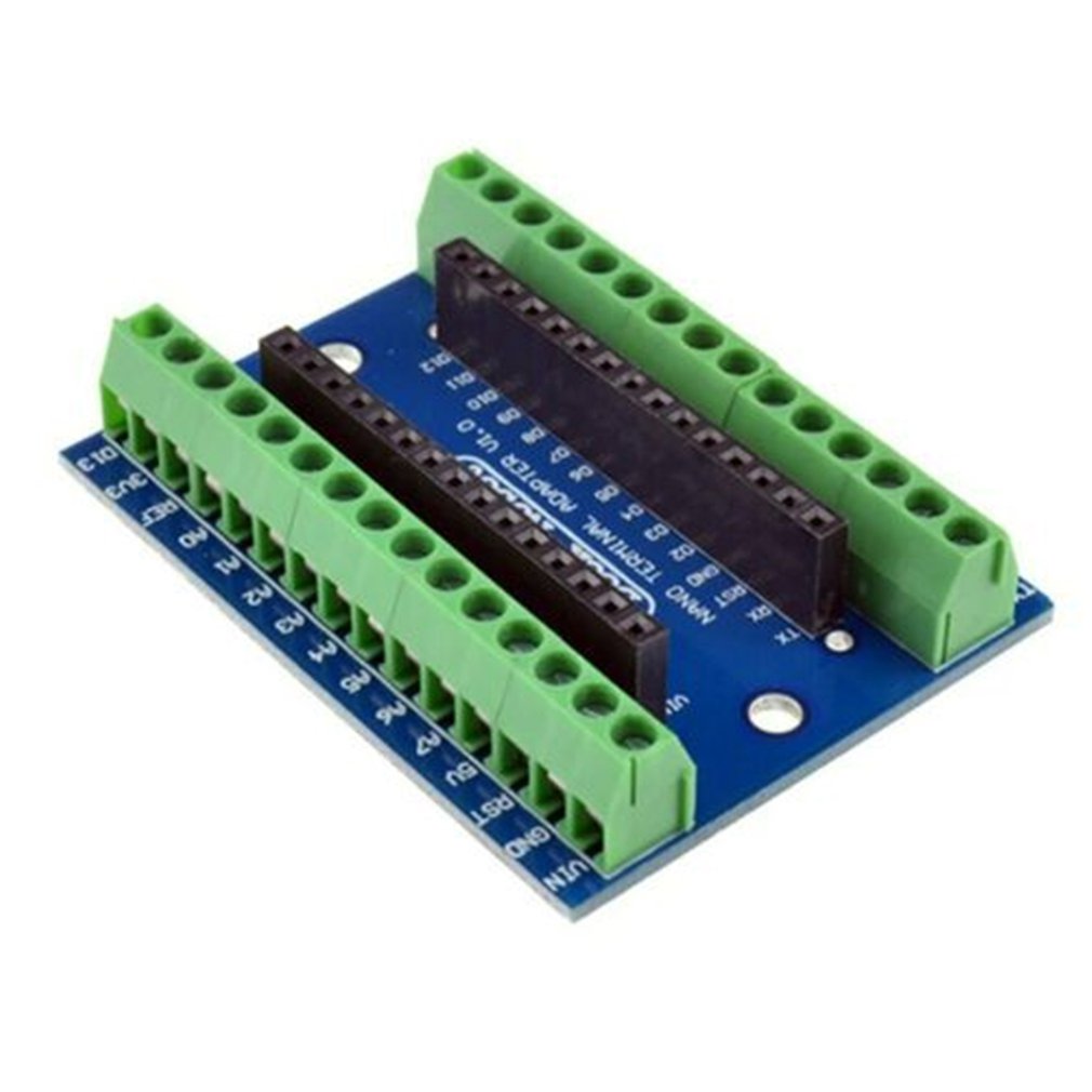

a Expansion Board Terminal Adapter for Nano as recommended by @Paul__B in post #4 would be a good idea
So that's what these are! I'm just discovering stuff. Will order this https://robu.in/product/nano-io-shield-expansion-board-arduino-screw-terminals/
