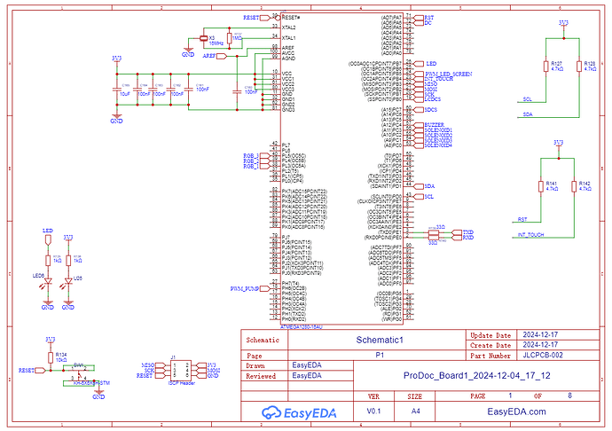

Help with atmega1280

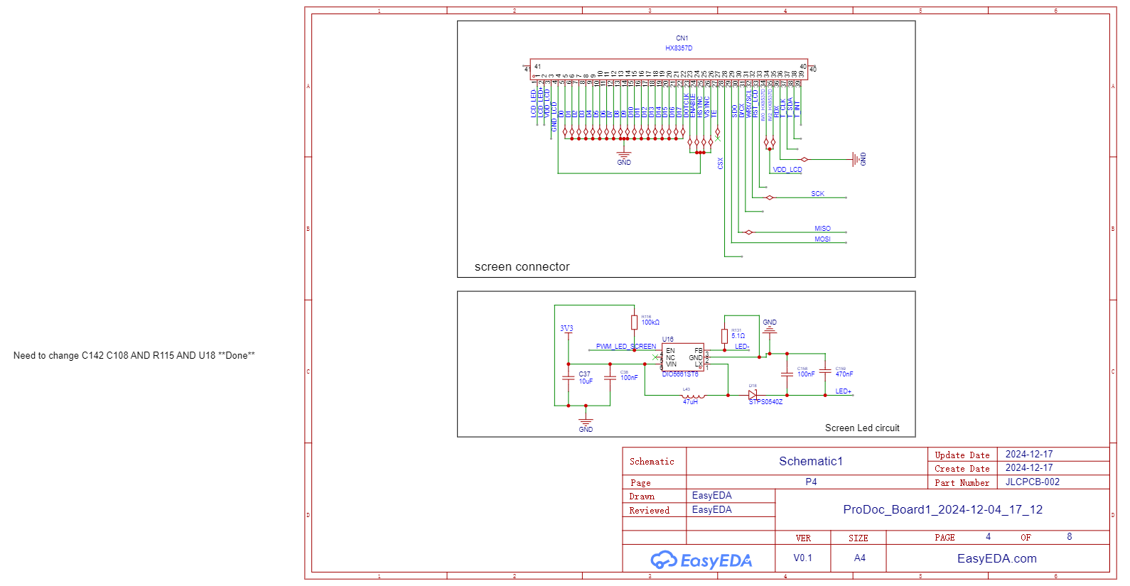

hey i cant attach here the scheme becuase im a new user
but i have a problem and im getting this error:
stk500_getsync() attempt 1 of 10: not in sync: resp=0xe0
avrdude: stk500_getsync() attempt 2 of 10: not in sync: resp=0x98
avrdude: stk500_getsync() attempt 3 of 10: not in sync: resp=0x66

and i burn the bootloader and when im trying uploading code using the usb i keep getting this error
so if someone can and want i can send the scheme in the mail
thank u all

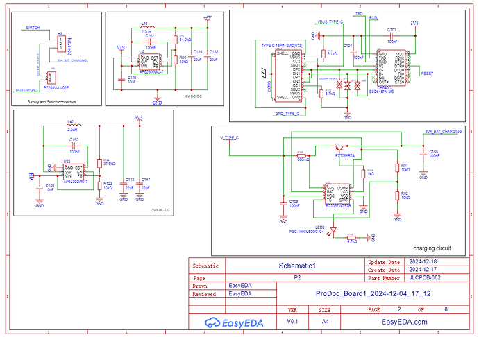

Meanwhile I noticed that I forgot a capacitor between the DTR(ch340c) to the reset(atmega1280)
This could be the problem?
Yes. The DTR pin is used to cause the MEGA chip to reset and thereby enter the bootloader. Add the capacitor and see if it works.

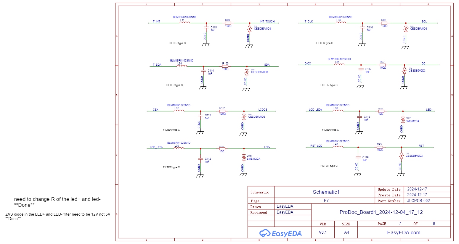

ok so this is all the page in the scheme
