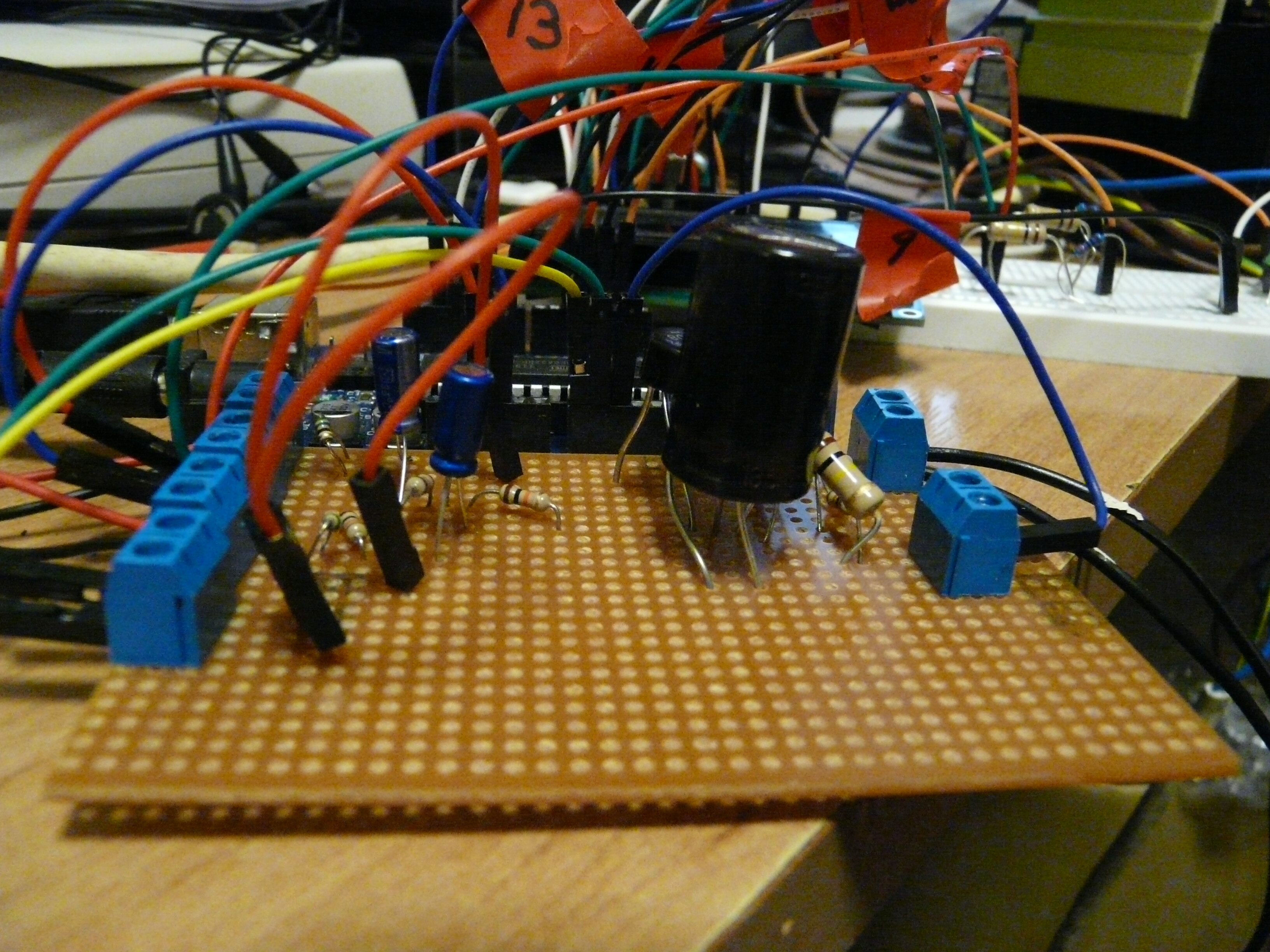

Anyway what ever it is you have it wired up wrong. The only thing that should be connected to the AC output lines is the bridge and the two 1M resistors. From the photo there are three things connected to that line and non of them is a 1M resistor.
There is only one on that page with a bridge rectifier on it. I am making a solar controller which will switch on a triak when there is spare solar power. It consists of 2 current transformers which measure power from the house mains and the other which measures the power being generated from my solar panels. also a 9vac power supply which measures the rms voltage all of the above is working perfectly I am just trying to get the bridge rectifier working so I dont have to get another power supply to feed my arduino.attached is a side on view of the board.

No there are two and nether match up with the photo you posted.

I honestly cant tell what connects to what, its just components on a board, for all I know its connected directly to mains and is shorted out

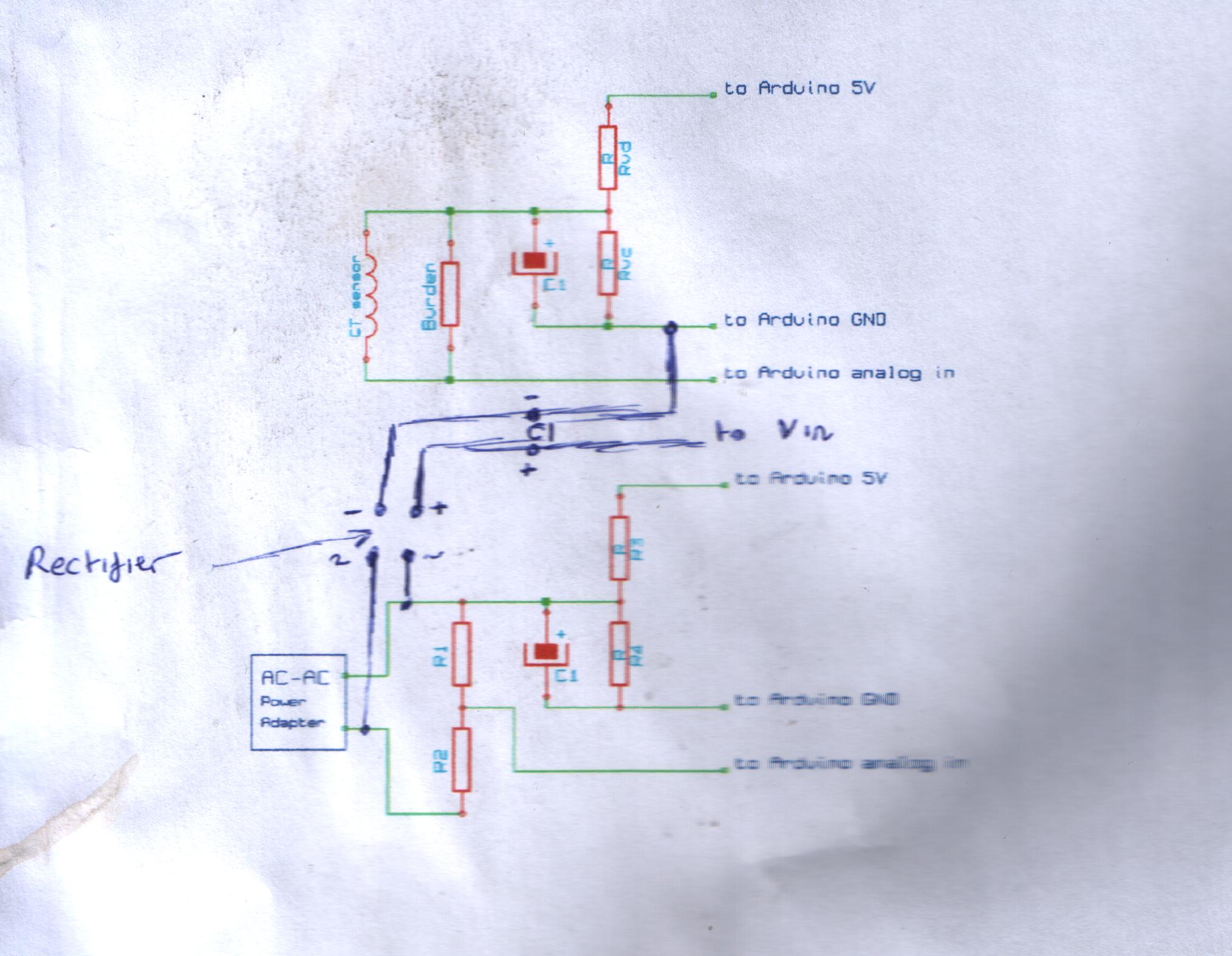

attached is a scan of my circuit. I have checked again with a different meter and I am still getting 19v dc. someone told me that I will get a high voltage output when there is no load connected, but should it be that high? and he told me to put a voltage regulator in the circuit. does the arduino have its own built in regulator and will handle up to 20v dc?
madmurg:
The problem is the R1, R2, R3, R4, and C1 components in the lower part of that drawing. What is the purpose of those components? I suspect that C1 is acting like a voltage multiplier adding to the output voltage of you rectifier circuit on the top part of the drawing. Temporaily remove those components from the circuit and tell us then what you measure on the DC output side of the rectifier.

The circuit is for a voltage measurement circuit
The step down voltage divider scales the AC voltage coming from the voltage adapter down from 9V to around 1V peak-peak.
The resistors R3 and R4 form a voltage divider that outputs a voltage at half the Arduino supply voltage of 5V. This voltage biases the AC voltage produced by the AC adapter and burden resistor by 2.5V, needed because the Arduino analog input channel requires a positive voltage.
Voltage at analog input = Bias Voltage + VsensV

As I said remove those components from the circuit temporarily and report back the rectifier voltage then measured.

I am not going to desolder all of these components as a newbie to electronics it took me about a week to get them working right. it was just an after thought that I decided to fit the retifier. I think I might just get a separate dc adapter and power the arduino that way.

Suit yourself. I just depends on if you want to learn something or just get a copied design to work, your choice.

In the bottom part of your circuit you have an electrolytic capacitor.
It shows that you know little about electronics because these capacitors ( unless they are very, very special ones ) do not like being connected to A.C.
Much as you may not like it for me to tell you this it could be DANGEROUS as it could easily explode.
Connecting this part of the circuit to your arduino will apply 50 times or 60 times per second ( depending on where you live ) reverse voltage to the arduino which will likely destroy it.
