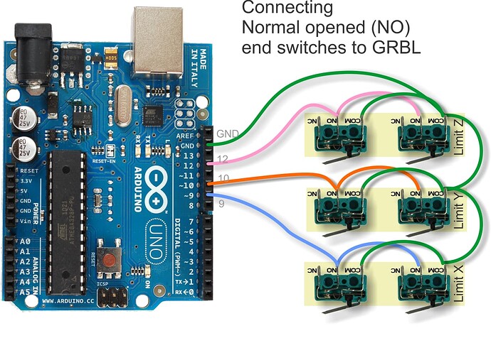

Also note that limit switches will always benefit from filters attached and shielded wire as these too can cause glitches.
Not sure what you are using in that regards ?

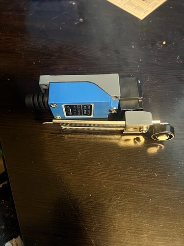

Regarding the filters on the limit switches, can you elaborate on what you mean? I'm just using the type in the attached picture. I'm using shielded 16ga, 2 conductor security wire. I don't have them installed yet. I'm 3d printing a flag to trigger them.

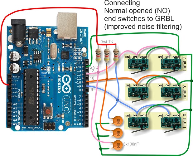

This is the most common arrangement but can be problematic.
This is the preferred method.
See here for more detail.

If however you are using them for other purposes you could do a little filtering at one or both ends. as shown in the pics.
