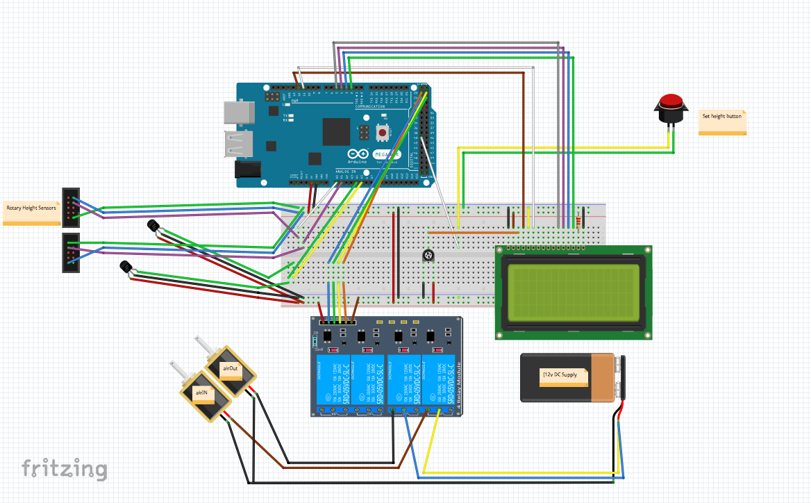

Hey guys, im pretty new to arduino. Working on a program to keep an object at the same height regardless of how much weight is on it - using an air spring. I have a rotary height sensor (headlight leveling sensor) to measure the height and im using two selonoid valves hooked up to a relay module. There is also a switch (I/O household lightswitch) wired in to tell the system when to recalibrate. I've had the program working somewhat okay before, but it wasn't 100% right and it was glitchy, so i wanted to include a few libraries(?) to simplify the code. I have reached a point where in a function within Equalize.cpp i need to call a function from UpDown.cpp. I don't have much experience other than 2-3 days with google. I've spent hours searching, but either the examples are bad or i don't even know what i need to be googling.

I am trying to use functions equalRR(); increaseRR(); and decreaseRR() from UpDown.cpp in my Equalize.cpp (library), but i can't get them to work. i've included both .cpp's both .h's, and my main file.
I've attached a (rough) Fritzing layout of my system.
Curious if there is an easy fix to this, or if i'm wasting my time going about it this way.
thanks for your time!
Mike
You can't get them to work? Or can't get them to compile?
If you mean "work" please define what "work" means.
Hey Nick, it seems to compile fine, but once the function is called - it doesn't appear to do anything. I've jammed some Serial.println(); in there to test it.
