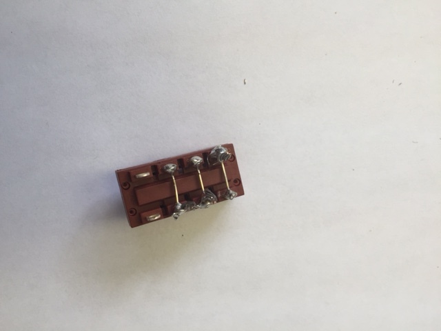

Here is the switch. I could not find an off-on-on anywhere so I too this one from a hair dryer.

You may have trouble with that switch. The first thing you have to do is work out which terminals are connected to which others, in each position of the switch.

As for the switch configuration, the ends of the wires are still attached so maybe this will help determine how it works?
1.The pin without wire is the off position,
2.the 2nd row of 2 pins was the first speed on hairdryer, are connected to each other and had a red wire.
3.the 3rd row of 2 pins was the next speed up on the hairdryer, are connected to each other and had a white wire.
4.the 4th row of pins are connected to each other and was a black wire.
So i am guessing the white wire was ground so in position 2 it was red(power) and white(gnd) and position 3 it was white(gnd) and black(power)??

Is this how your switch is configured (view from underside) ?
For example, in position 1, pins 1 & 2 are connected together and pins 5 & 6 are connected together.

I am not too sure without taking it apart which I could do I was just afraid I may not get it back together again. It wasn't easy to find. I was hoping the way it was wired in the hairdryer would shed some light on that. I left the wires as is where they were attached at the pins (see pic below which is upside down relative to your drawing I think)because I believe the hairdryer was functioning in a similar way I would want it to. I am not sure how it is wired internally but whoever wired it for the hairdryer has pin 2 attached to pin 6 then a red wire out...3 attached to 7 then a white wire out....and 4 attached to 8 with a black wire going out of pin 4(opposite side of other wires). Am I right in assuming the white would be ground since it would be in play in both "on" positions? The red is power in position 2 and the black was power in position 3?? Sorry if this seems elementary but I am quite clueless with this stuff.
There is no need to take it apart and there is no need to unsolder the bridged connections, but a battery and LED (if you haven't got a multimeter) could help determine how it is configured.

Cut the existing bridges on the switch between 2 - 6, 3 - 7 and 4 - 8
Warning: if opposite switch connectors (eg 1 & 5, 2 & 6 etc. are connected together internally, this will not work)
Test the switch configuration to check it behaves as in the diagram below.
Now connect the switch
Switch connector 2 connects to Switch connector 4 (bridge on switch)
Switch connector 2 connects to Arduino power jack (*depending on battery voltage)
Battery positive (+) connects to Switch connector 3
Battery negative (-) connects to Arduino ground
Test the switch now switches the Arduino off in position 1, but on in positions 2 and 3.

Ok I will try this. A few things have me confused though.
1.Why a 1k resistor vs a 10k resistor (suggests 10k in reference section)?
2.To test the switch's current configuration (after I cut the bridges) which pins to I connect the battery and meter too in position 2 and 3?
3.You say depending on battery voltage for connecting to Arduino power, isn't anything 12v or less ok?
4.Is using INPUT_PULLUP just a way to save me from connecting an external resistor?
5.In switch position 2 wouldnt arduino pin 4 actually be HIGH since the switch would be closed? and in position 3 arduino pin 5 would be HIGH? You show them the other way around. I must be missing something.

Answers in bold in your text:
homer2121:
1K is a series resistor to prevent a wiring fault damaging the Arduino pin. 10 k is usually a pull up /pull down resistor to give a pin a clear state.
Position 1
The following should be connected: 1 to 2 and 5 to 6. No other combinations are allowed
Position 2
The following should be connected: 2 to 3 and 6 to 7. No other combinations are allowed
Position 3
The following should be connected: 3 to 4 and 7 to 8. No other combinations are allowed
7 to 12+ volts must go through the regulator so use the power jack. A battery of less than 5.5 volts is connected to Vin on the Arduino.
Yes
The switch switches the pin to ground, not to + so it is LOW when switched. This is standard with a pull up resistor.
