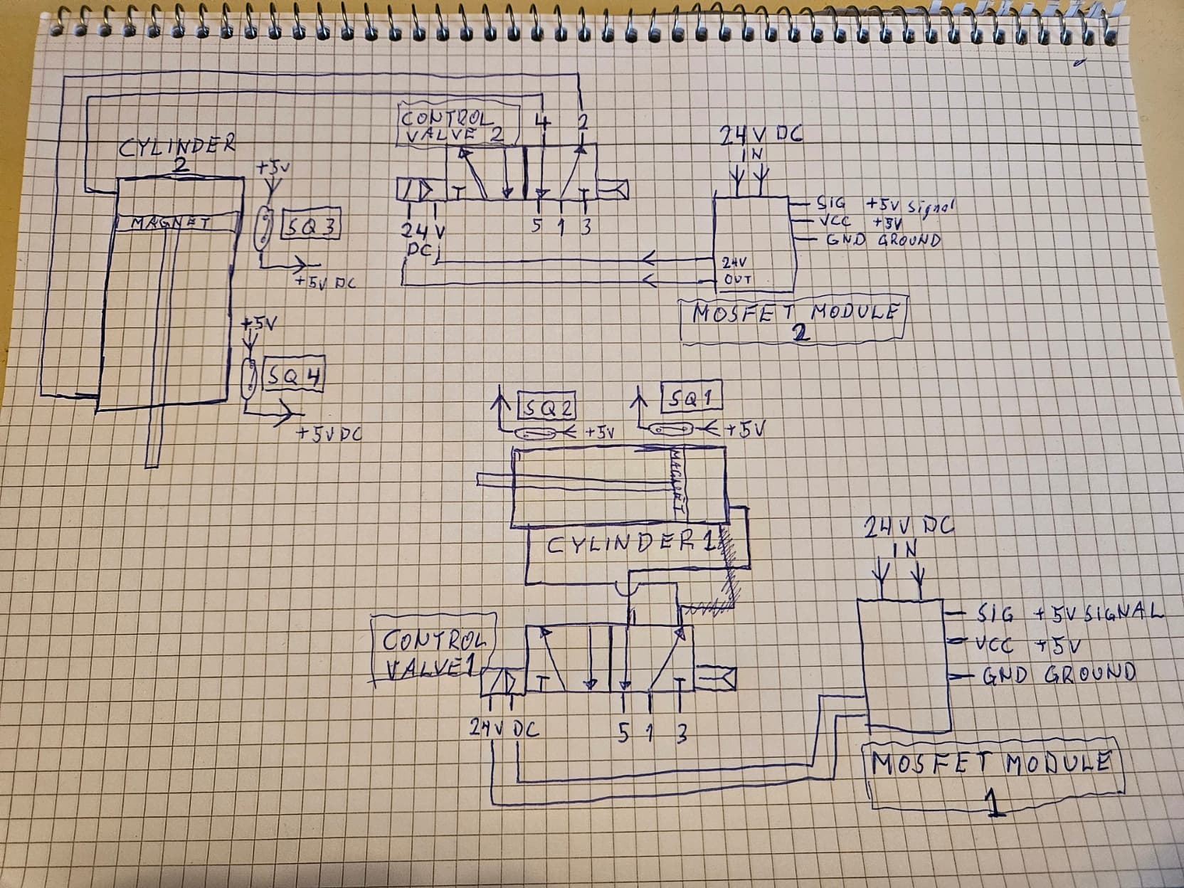

Attach a simple schematics how everything will be connected,hope it will show my intention.
First,the thing I want the "machine" to do:
In normal inactive state,both cylinders are retracted,and control valves are without signal.
SQ#1 and SQ#3 gives a +5vDC outsignal.
When it start,(button,power up or similar,no preference how to start the sequence),cylinder #1 should extend to end,(SQ#2 gives a +5v signal),and retract directly.
When cylinder #1 retracts,Cylinder #2 should extend to end and retract directly.
(SQ#3 and SQ#4 send a +5vDC outsignal when retracted and extended.)
Then cylinder #1 should extend and retract again,and cylinder #2 again....on and on constantly until I power down,flip a switch or similar.
Start and stop can be Power down the module or by a switch,no need for advanced solutions to start and stop,main thing is to get a safe loop to run this sequense for say 4-500 cycles.
IF possible can it be done in some way when using the SQ1-4 for signals to the Control Valves?
Say cylinder #2 can not extend before cylinder #1 have retracted?

Anders, can you please post links to the specs of the control valves and proximity switches.
It is not clear whether MOSFET modules or H-bridge modules will be needed to control the valves.
The description of the proximity switches is ambiguous because PNP implies perhaps a Hall-effect sensor but "Reed type" implies a magnetic mechanical reed switch.

The Mosfet Module I have are rated for max 5A output,(1A without heatsink)
Here are links to them:
744989_87045_manual_en.pdf (kjell.com)
No Title (kjell.com)
I also have "normal relays" for Arduino if they are "better" or more useful in this application then the Mosfet?

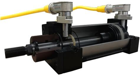

All depends on what you are using for switches and where they are placed. All mechanical switches will give false connection indication if you are testing for a switch closing. The contacts are always spring loaded and will bounce. If your limit switch just opens, then any bounce can be ignored. The Arduino is so fast it will detect bouncing switch contacts. So, beware when you write the program.
Similar to one of these?
Switches are obviously placed at the end of the cylinder/piston/rod/actuator travel (drawing above). Switch bounces should be easy to manage considering the Arduino workload.
Not to mention the switches Anders suggested have Hysteresis (overkill switches for a home project in my opinion).
You only need to connect the switches as they should. NPN D-M9N(E) or D-M9N(E)V should be OK with a Pull-up resistor (connected to 5V). With a max 100 µA leakage current, a 10K resistor should be OK.
If using the PNP D-M9P(E) D-M9P(E)V, a 10K pull-down (connected to the ground) will do.

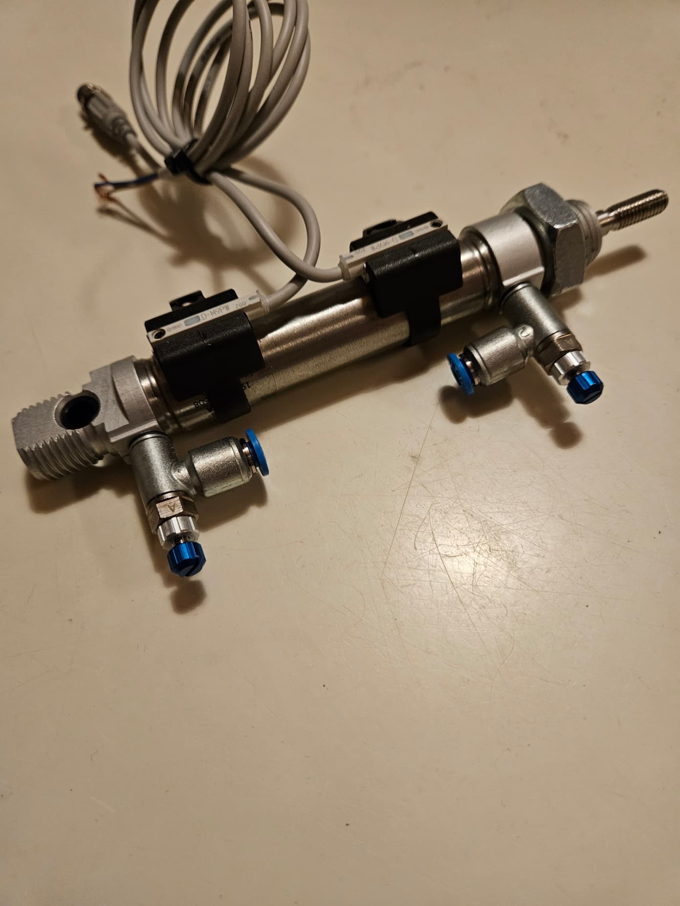

Yes Doug.
It's similar,the photo are of "Cylinder #1" that will be used,same switches on both cylinders.
#1 are a small cylinder with 60mm stroke,#2 are bigger with 80mm stroke.
But same switches on both cylinders.

Don't forget to add a freewheel diode in parallel with every electromagnetic actuator you connect (relays or those Festo CPE14-M1BH-5L-QS-8 control valves).
The cathode (generally marked with a ring) should be connected to the positive side as shown here.
Any 1N400x should do.

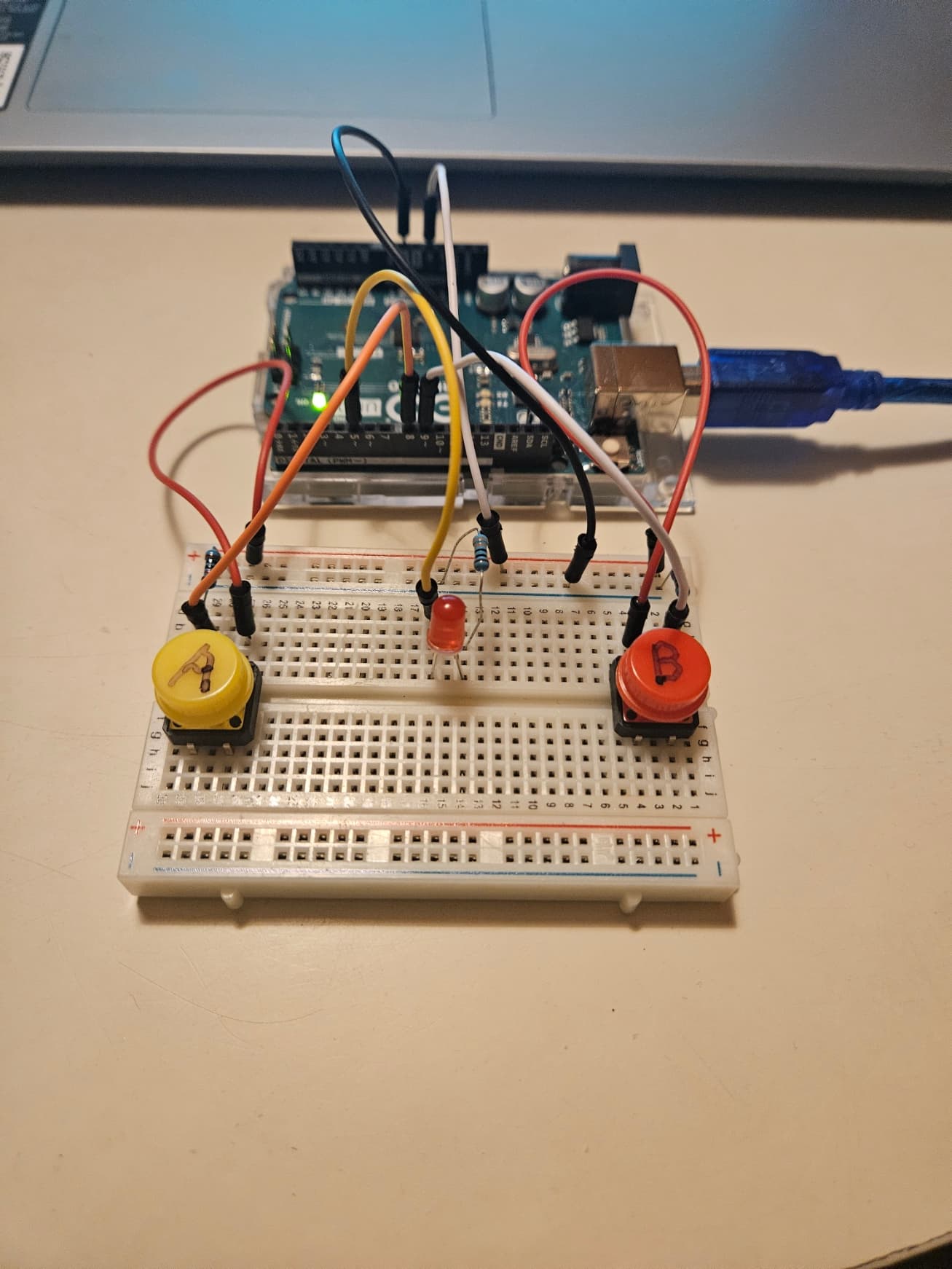

Did a very basic sketch and put it together on the board.....2 buttons that simulates the cylinderswitches,and a LED that simulates the relay for the pneumatic valve.
Did this to try to learn the basic,and get a function of the valve get a signal so the cylinder extend and retracts by the signal from the switches.
Very simple sketch,and no "safety",but it should work this way.
Now just try to figure out how to duplicate this,and let the other cylinder and valveloop to be controlled by the first loop.
Did plenty of misses before it worked....casesensitive,brackets and how to designate each pin....new world to me,but hopefully I will learn more!

That's an excellent start !
The way it is written, the digitalWrite(relay, HIGH) instruction is executed over and over again as long as the switch is pressed.
Next step could be to execute it only once. To do that, you can read the relay (yes, outputs can be read too) and write it only if it's LOW using Boolean Operators.
Or use a variable (int relayStatus = LOW) that is toggled each time the relay is toggled :
  digitalWrite(relay, HIGH);
  relayStatus = HIGH
That's one step towards state machines
To control more cylinders, I first suggest more meaningful switch and relay names :
int cyl1ExtendedSwitch = 8;
int cyl1RetractedSwitch = 9;
int cyl2ExtendedSwitch = 10;
int cyl2RetractedSwitch = 11;
int cylinder1 = 5;
int cylinder2 = 6;
You can also define constants
#define PRESSED HIGH // This means that writing HIGH or writing PRESSED is equivalent
#define RELEASED LOW
#define EXTEND HIGH
#define RETRACT LOW
So now, your code can be "self explanatory" :
 if (digitalRead(cyl1RetractedSwitch) == PRESSED )
    digitalWrite(cylinder1, EXTEND );
  if (digitalRead(cyl1ExtendedSwitch) == PRESSED )
    digitalWrite(cylinder1, RETRACT );
Controlling more cylinders can be done the same way : cyl1switch triggers cyl2 movement and cyl2switch triggers cyl1 movement.
But the state machine (third step i'd say) is a more appropriate way to do that. You can read tutorials to get familiar with it.
By the way, do you know Wokwi ? It's a simulator that allows you to test your program with the hardware you don't have yet or switches you don't have room for on the breadboard...
Do you have a multimeter to measure the current drawn by the Solenoid valve CPE14-M1BH-5L-QS-8 ? It should be about 60mA under 24V...
