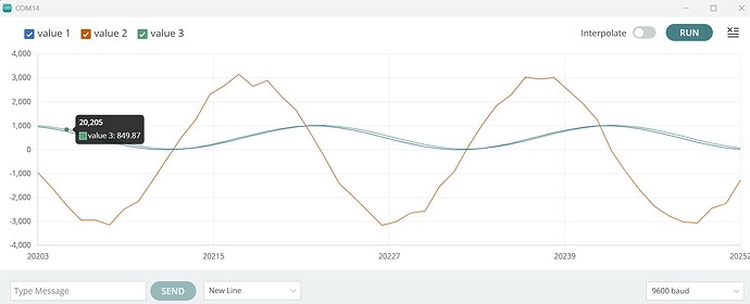

Hello again,
Just to say it's my first hardware tests on Arduinos, I have found a couple of things.
  1. in my code v2 change the I=0.0; in the initialise part to I=D;
  2. replace the two lines "Serial.println( ...);" by a single line:
    "Serial.print(v); Serial.print(", "); Serial.print(D); Serial.print(", "); Serial.println(I);" but put it inside the integration loop (just above the preceeding "}", and use the Serial Plotter output to look at the results.
I used a MKRWifi1010, added a 0-3.3V, 1Hz sinus wave to port A1 (Pin=1) and I get some interesting results. "v" and "I" are in phase from 0-1024 about (with a slight delay due to the simple integration method. And the D is a "noisy" +/- 3300 count symmetric sine.
If you keep my original "I=0.0;" in the initialisation you will get a I sinus that is offset, depending on the first value of "v". I believe you will understand that once you think over it.
Then the Arduino being powered by a 0-3.3V power supply. it's normal that the adc counts "unsigned" from 0-1024, no ?
Here is my v3 code :wink:

That seems to be the case, but integrating the derivative function should also give a symmetric result, which does not happen. The operation does its job, but it brings back the DC constant that was previously removed by the derivative. The problem even persists on another board, like the ESP32. Thanks for replying.
The answer may have something to do with the fundamental theorem of calculus.

Hello,
You are right, but your integration formula with my "Iprev+" or your "I1+" variable offsets the result. If you rewrite the integration formula as "I = (D + D_prev) / 2.;" you will get a sinus that is the same as the "D", but offset in time with a full time step, with respect to the original ADC value.

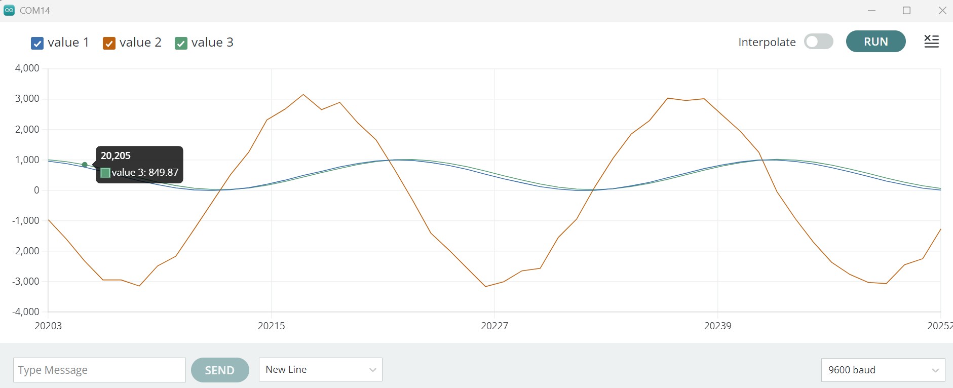

Hello,
Yes, and no, my "if ..." was in the setup() for my previous version, but as I believe this code could be called several times, therefore I proposed here to add it in the main loop() .
Normally for me such a code comes in a function.
And for the delay(2000); I'm not yet sure if all Arduino function calls return when fully finished, or if they are triggering a sequence driven by interrupts in the background.
Well, I'll stop for tonight, but this v5 works sometimes, but it gives different integration offsets depending on when I hit the Arduino reset button, which means that my initial integration value is varying, probably because some interrupt has delayed the code between my initialisation and the first sample. Sometimes the integration is symmetric, sometimes no and the offset depends on the moment I hit the reset, w.r.t. the sinus wave value.
Next step would be to use the true time between two readouts, and not the expected time.
// derivation and integration example 2025 feb 17 v5
// for MKR WiFi 1010
const pin_size_t Pin = A1;     // Analog input pin
const unsigned long msT = 50;  // desired sampling time in [ms]
const float Tk = 1000. / float(msT);  // inverse of sampling in [ms]
unsigned long t = 0, t_prev = 0;  // millis() timer values
int v = 0.0, v_prev = 0.0;        // Voltage values integers
float D = 0.0, D_prev = 0.0;      // Derivative values
float I = 0.0, I_prev = 0.0;      // Integration values
bool Init_DerInt = true;          // Initialise the derivative and integrand
  pinMode(Pin,INPUT);             // set Pin A1 to analogue input
  analogReadResolution(10);       // default for MKR WiFi 1010
  delay(1000);                    // hope this is enough to settle any initialisations
// DERIVATION AND INTEGRATION
if(Init_DerInt) {     // if true initialise
  t_prev = millis();  // initialise first values, get time
  v = analogRead(Pin); // get analog readout
  D = float(v);
  I = 0.0;
  Init_DerInt = false;    // init done
  t = millis();               // get time in [ms]
  if ( (t-t_prev) >= msT ) {  // wait msT milliseconds, integer arithmetics
    v_prev = v;               // bump old value
    v = analogRead(Pin);      // get new analog value first to avoid any interrupt delays
    t_prev = t;  // keep new time in [ms] and assuming ïs ((t - t_prev) == msT) exactly !
                 // a better way would be to use the correct time readings, in case of delays
                 // which means Tk needs to be fully recalculated each time,
                 // and with en precision of +/1 [ms] that may integrate and still give offsets too.
    D_prev = D; // bump old value
    I_prev = I;
    D = float(v - v_prev) * Tk;  // looks OK
    I = I_prev + (D + D_prev) / 2.0 / Tk; // gives different offsets depending on when I hit the reset button
  // at 9600 bauds with 10 bits per character in 50 msec we may write <<48 characters before interfering with sampling
  // Serial.println(t); Serial.print(", "); Serial.print(Tk,6);
  // Serial.println(ARR); Serial.println(ADCscale,6);
  // Serial.print(v); Serial.print(", ");
  // delay(1000);
Not sure what you mean by that. Functions are C++ functions, they return to whatever part of the code called them.
And delay() is blocking the main code that called it.
