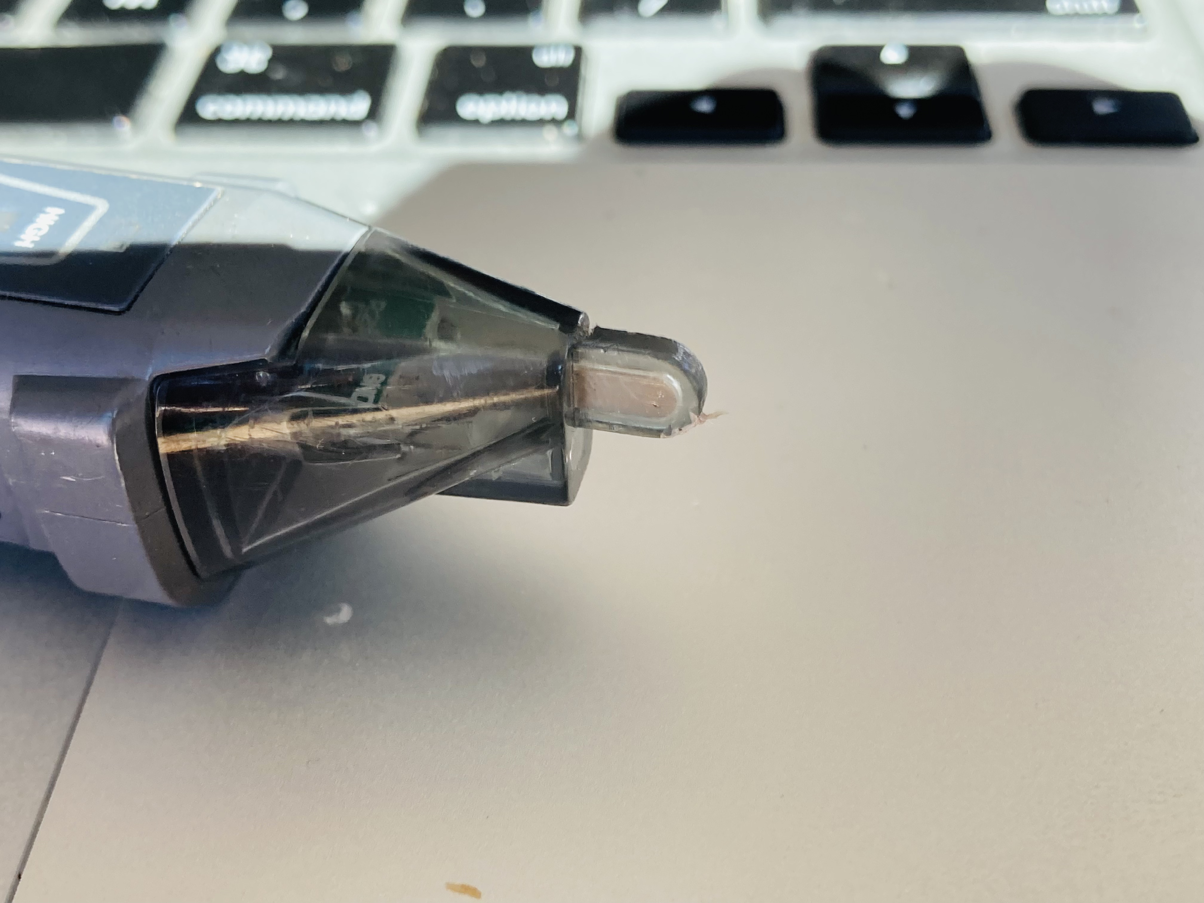

Really :thinking:?
I do electrician stuff every so often, so I have my favorite pair of wire strippers and a simple voltage detector to make sure the line is off. It has 3 levels of sensitivity and three LEDs to indicate signal strength. I know that this device senses EMF to check voltage, but how would I copy that? It seems very basic. When it is put near a power source, it beeps and all three LEDs light up; when not, nothing happens.
How could I make mine do that, instead of what it is doing :thinking:? Not necessarily the three LEDs and the buzzer, but the way it reliably reads an EMF. It seems like I am missing something simple.

Maybe. It could also contain a coil of wire connected to measure an electric field.
Hmmm. In the tip of the device, you can see a small metal plate that seems to be the antenna.
The voltage detector:
