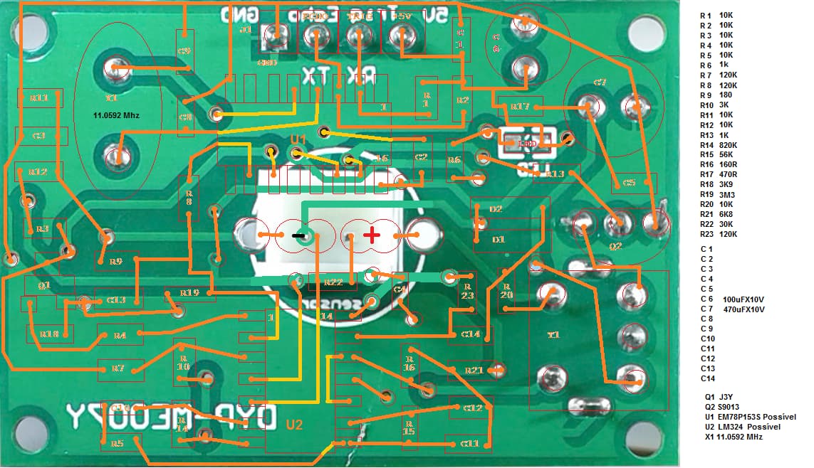

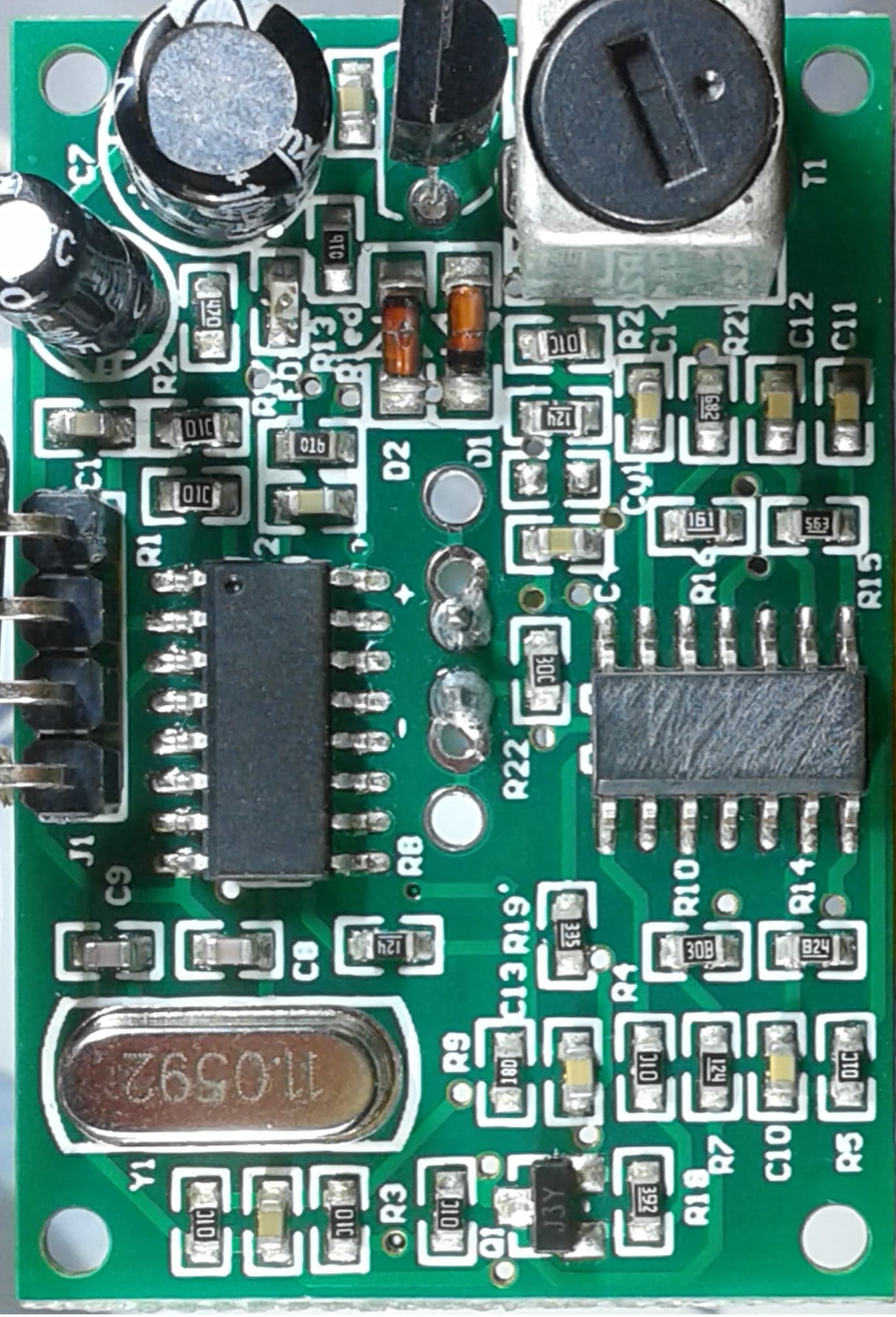

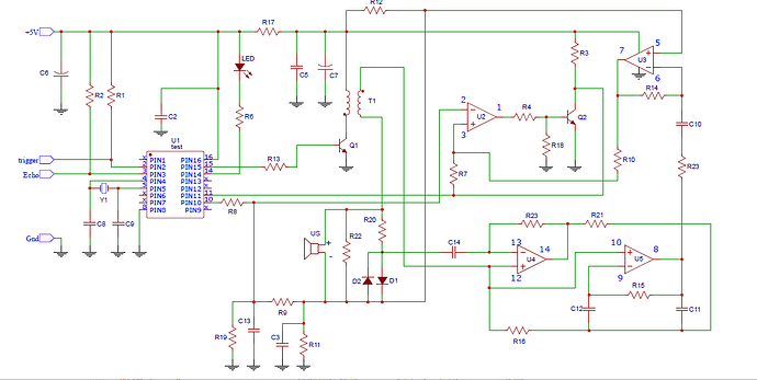

This is the JSN SR04T module board.
Front:
and rear
I reverse engineered it using this image:

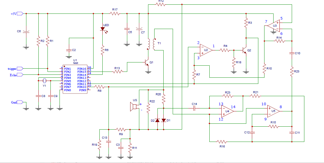

and I drew this schematic of it.

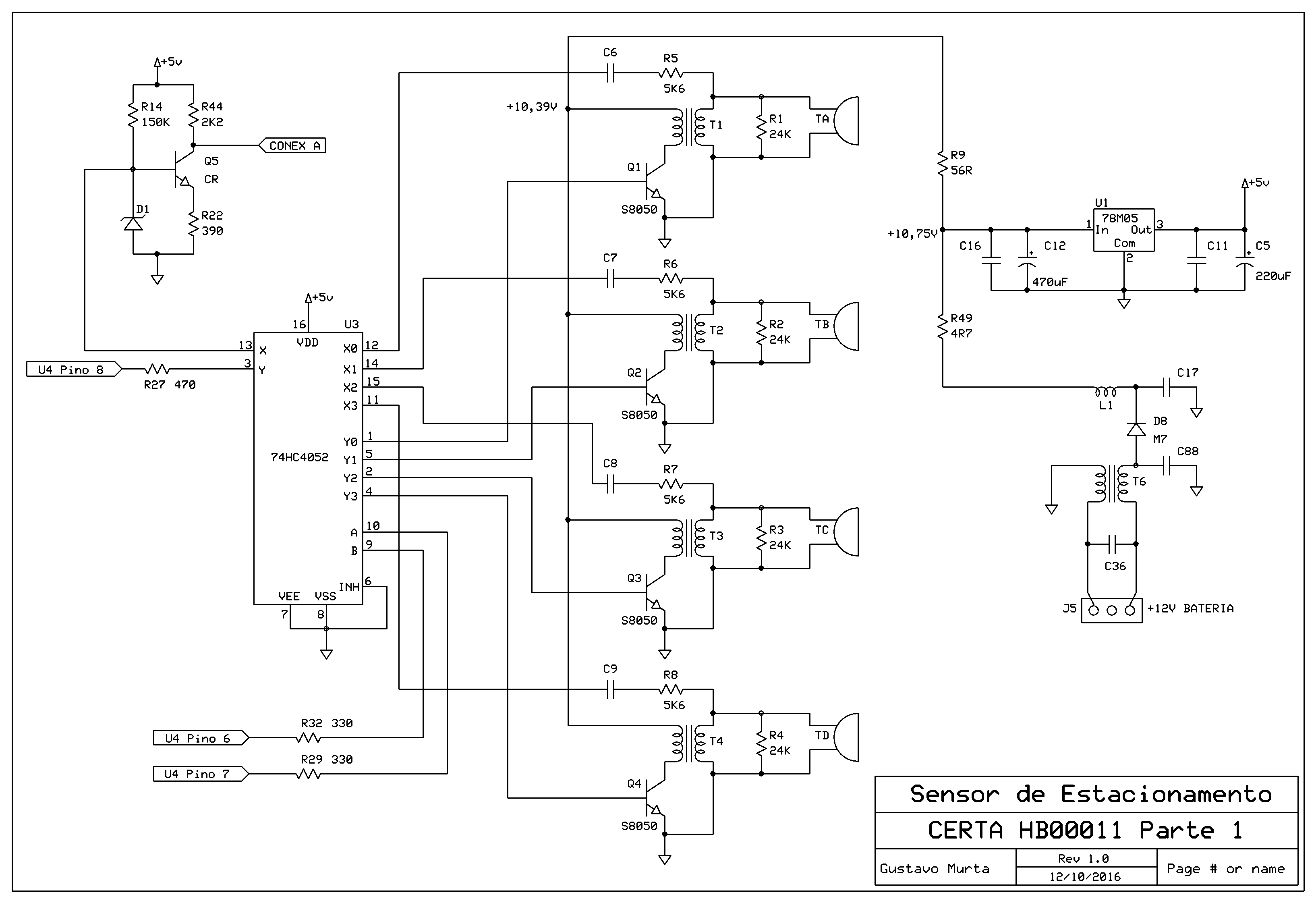

The U1 chip maybe a processor, but I don't find number.
I already have this. the DFRobat Version, uses UART, kind of a bad choice
this is really helpfull, but how can you make it into 2 or even 4 probes?

No, this model is for 1 single probe only.
Same as what you posted in #14.

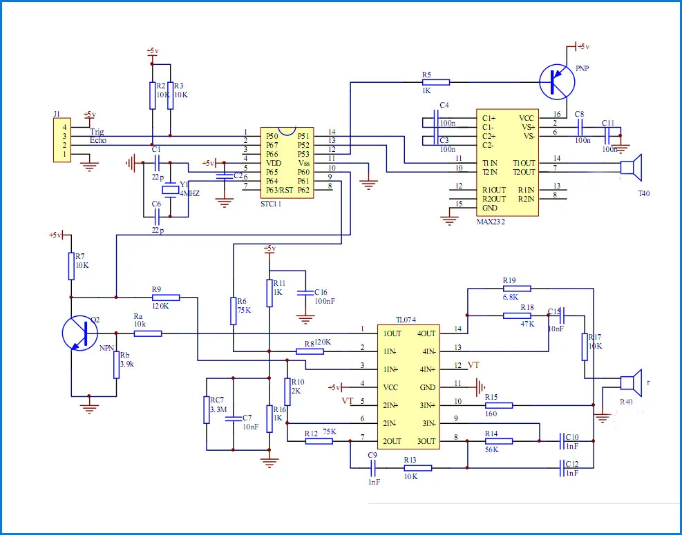

And this is HC-SR04 schematic.

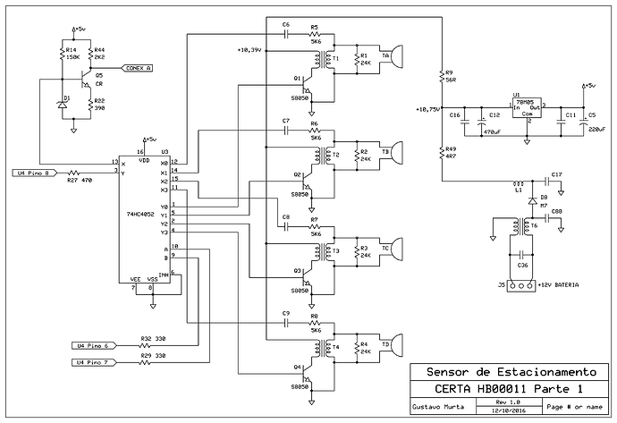

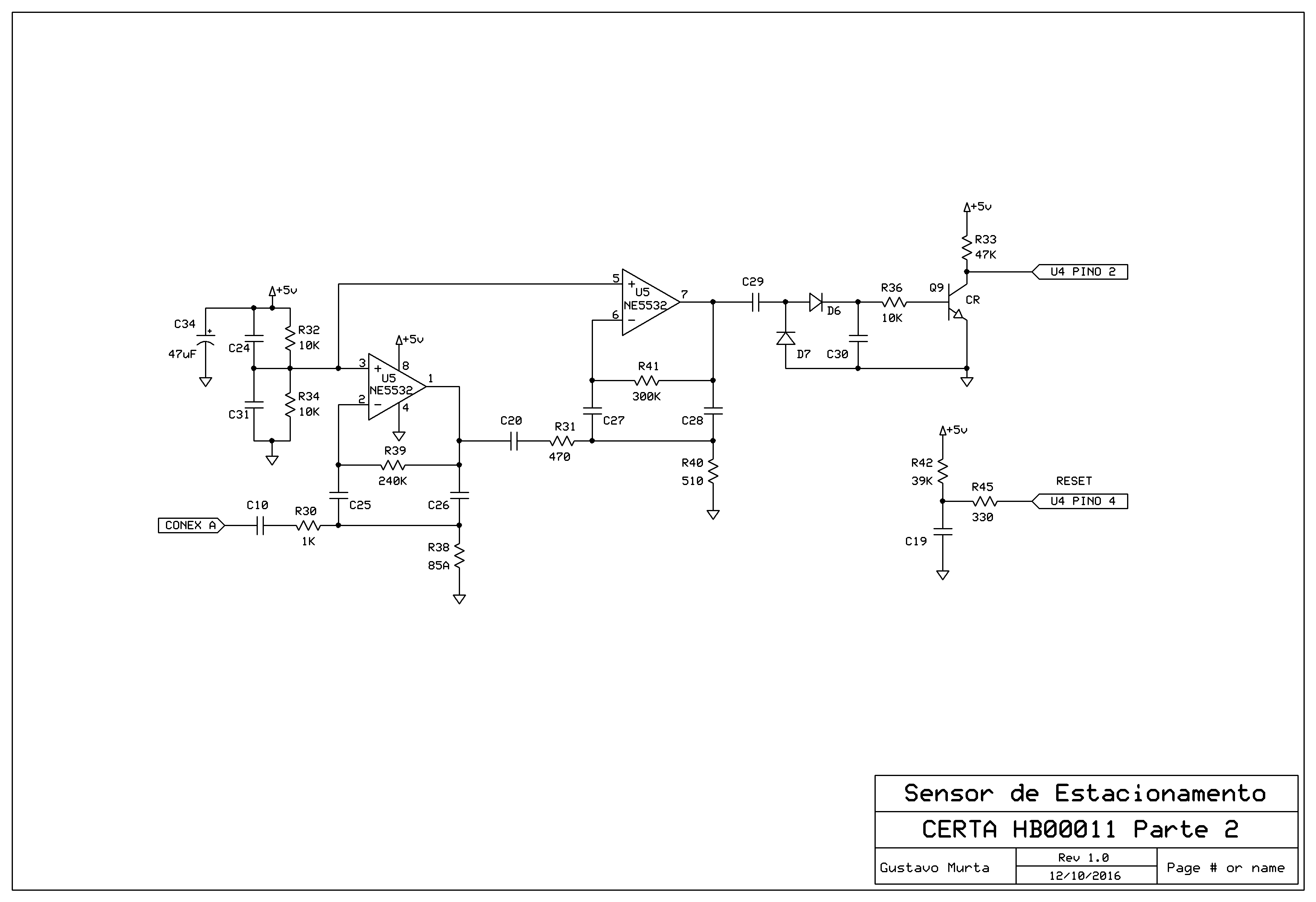

And this is my friend project for 4 sensor.
thank you. this is very helpful.
the 4 sensor part means the other is the transmitter and the other is the receiver or the 4 transmitters and after that, they became the receiver, making it work just the same as JSN SR04T?
