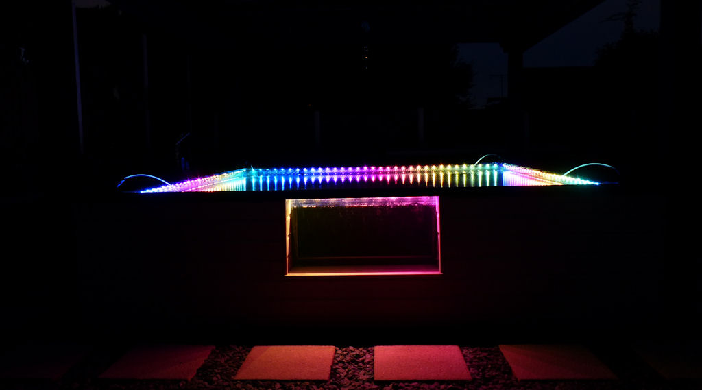

Another thing, the lights relay has pretty much never been used as they stopped working, probably within the 1st year or 2. They looked nice when they worked though, and colors/patterns were configurable through a web interface.
