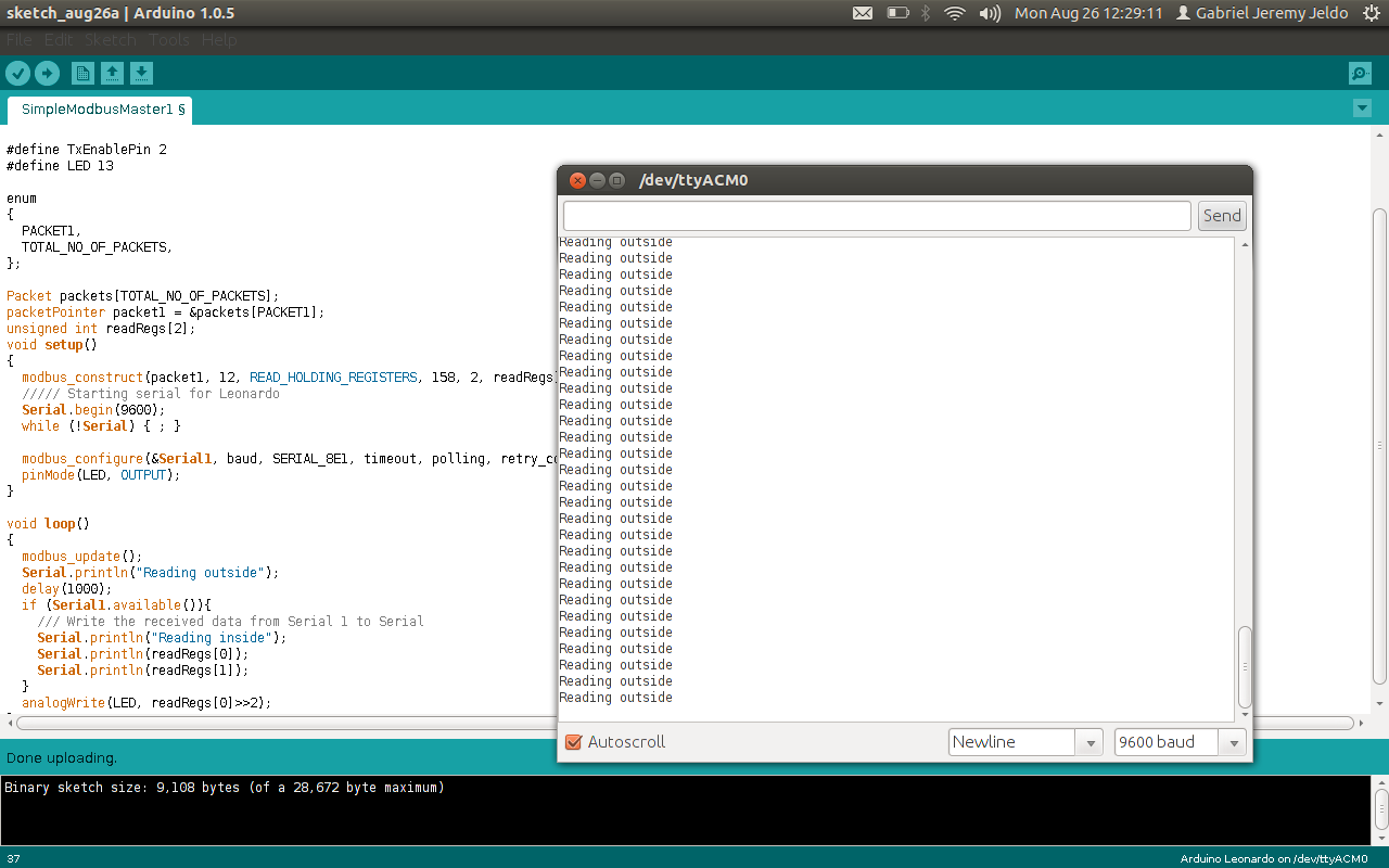

This is my code which i have burned inside arduino

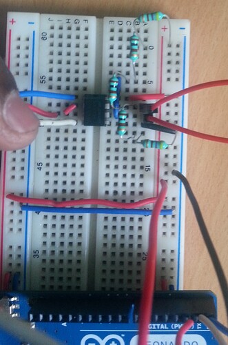

Hello,
I tried with the schematics from simple modbus. Didn't Work.
Tried a breakout board for RS-485. Didn't work.
Serial port hangs never enters the if condition where it checks if hardware serial is available using breakout board.
Reading output of hardware serial. Giving junk values without even connecting wires.
Please help. Thanks

Still no output :frowning:
The third attachment still uses Serail1.available() and the other one uses Serial1.read(). This wont work.
Use Serial.println(readRegs[]) or something similar like you already did to transmit the received values from Serial1 (the modbus connection). Again you cannot use Serial1.available() since it will most of the time be empty depending when you read it. The library reads the received information and stores it in the assigned register array, in this case readRegs[]. This is the only way of interfacing with the information received.

Hello JuanB,
Thanks for the reply.
I printed this
  modbus_update();
  //if (Serial1.available()){
    /// Write the received data from Serial 1 to Serial
    //Serial.println(Serial1.read());
    //Serial.println(readRegs[]);
    Serial.println(packet1->requests);
    Serial.println(packet1->successful_requests);
    Serial.println(packet1->failed_requests);
    Serial.println(packet1->exception_errors);
    //Serial.println(readRegs[1]);
  analogWrite(LED, readRegs[0]>>2);
but i'm getting
50
0
50
0
that is requests made 50 but all failed requests.

Hi meetjeremy, since the information is scattered could you please mail me your complete sketch to bester.juan@gmail.com.
Maybe I have asked this but did you connect the driver ic (or break out board) according to the RS485 connection schematic on the SimpleModbus site?
What arduino are you using?
Hello JaunB,
I'm using Leonardo for this project.
Yes i have connected the circuit according to the schematics.
I have sent you the code in your mail.
