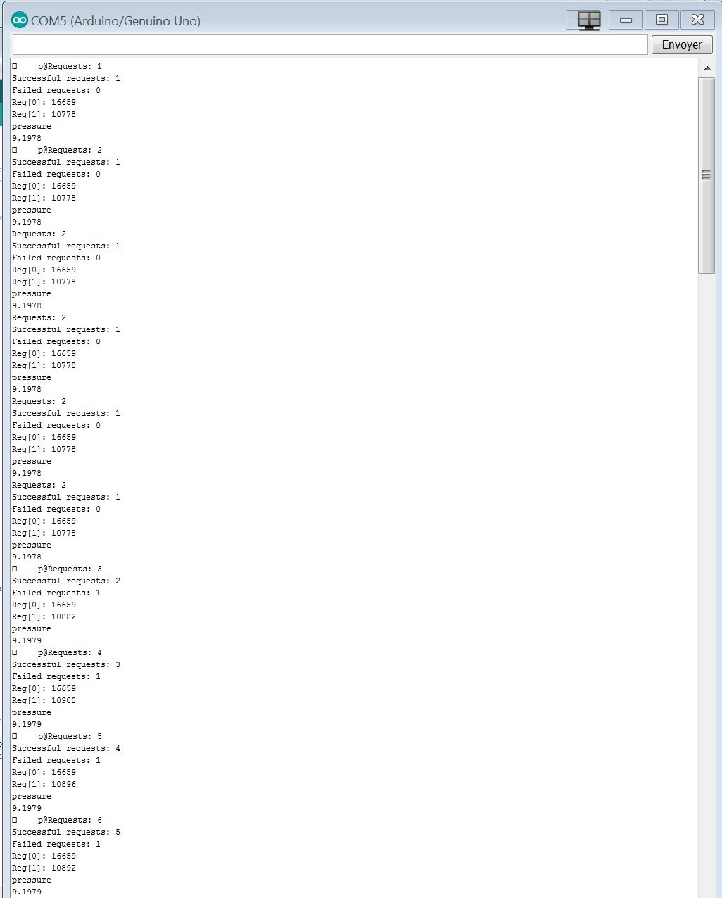

I have written my program using SimpleModbusMasterV2rev2 library and I fixed the problem.
Now I can read the pressure value, but a question still remains.
Some garbage comes on the request message. There is a way to eliminate it and optimize the communication?

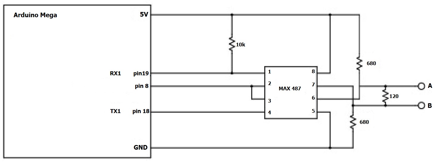

I attached the program, the hardware set-up, the serial monitor screen shoot and the pressure manual.

  modbus_configure(&Serial, baud, SERIAL_8N1, timeout, polling, retry_count, TxEnablePin, packets, TOTAL_NO_OF_PACKETS,readRegsPress);   // Initialize the Modbus Finite State Machine
You're using the same serial interface for the RS-485 (ModBus) as you use for the debugging information. So I'm not surprised that some information doesn't transmit as you expect it. Although the driver should be disabled during that the ModBus library expects to rule the serial interface without disturb.

Sorry, I forgot to put the schematics of both.
Thank you so much, you are right, now it is working.
If I remove the conditions:
if(packets[PACKET1].successful_requests > last_successful_requests1)
last_successful_requests1 = packets[PACKET1].successful_requests;
if(packets[PACKET2].successful_requests > last_successful_requests2)
last_successful_requests2 = packets[PACKET2].successful_requests;
The parameters come in a strange way, as you can see from the screen shoot.
I am obliged to keep the conditions (see screenshoot), but if I want to put both the parameters in a unique formula like:
