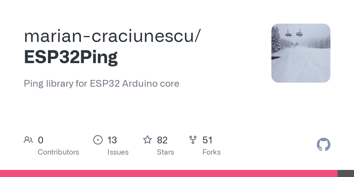

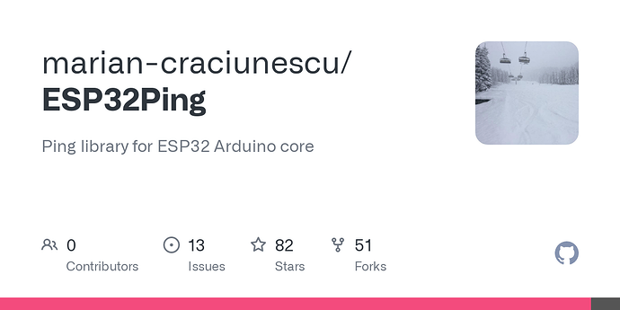

Thank you. But I have wifi. I can ping ESP IP address, I can flash with OTA.
can the esp32 ping?
Wierd,
Can ping local IP.
My broker IP
Mosquitto IP
This is mosquitto IP
Connecting to WiFi
WiFi connected with ip 192.168.121.110
Pinging ip 85.119.83.194
Success!!
You've lead me to the solution.
I've binded MAC address to IP with previous ESP. So I can't use the same IP. I was using fixed IP.
