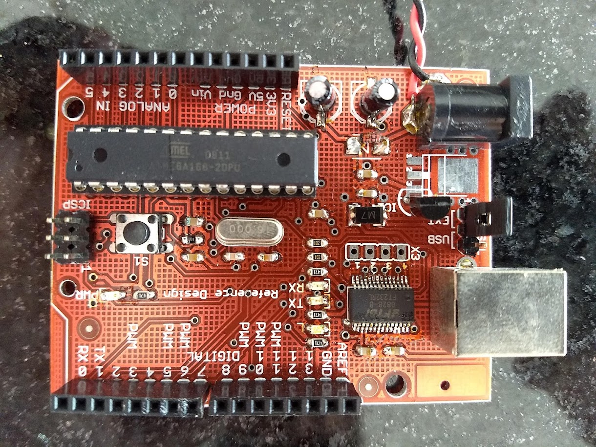

Help with Old NG board
Hi, I found an old Arduino NG board from 2008, but I'm having trouble uploading... help?
Processor: ATMEGA 168-20PU
FT232-RL
Arduino: 1.8.19 (Windows 10), Board: "Arduino NG or older, ATmega168"
Sketch uses 924 bytes (6%) of program storage space. Maximum is 14336 bytes.
Global variables use 9 bytes (0%) of dynamic memory, leaving 1015 bytes for local variables. Maximum is 1024 bytes.
C:\MyApps\Arduino\hardware\tools\avr/bin/avrdude -CC:\MyApps\Arduino\hardware\tools\avr/etc/avrdude.conf -v -patmega168 -carduino -PCOM5 -b19200 -D -Uflash:w:C:\Users\082428~1\AppData\Local\Temp\arduino_build_174185/Blink.ino.hex:i

avrdude: verification error, first mismatch at byte 0x0000
         0x00 != 0x0c
avrdude: verification error; content mismatch

I am not an NG expert.

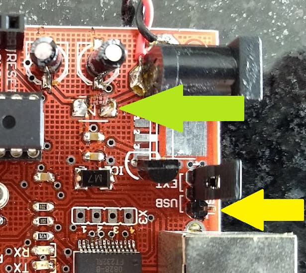

Is that widget (yellow arrow) in the correct position? Should it select "USB"?
Also, it is not a problem right now but there is a diode missing (green arrow) - will not work with the 'barrel jack' without it.
Hi, thanks for answering!
The photo was before I connected to computer, I already moved the jumper to USB position, then it turned on.
The diode is there, it's just hard to see in the picture.
Note I am able to communicate with the board, and in the serial monitor I can still see debug messages I added for the sketch I uploaded to that board years ago (a temperature control program).
Thanks
Maybe try with a much older version of the IDE ("Arduino 19" or what was in use back then).
I tried with Arduion-0023 version, got same error... I suspect it can be the driver, but wasn't able to install the old drivers in Windows 10, maybe I will have to try in an older version of Windows that accepts those drivers
Or ICSP ?
