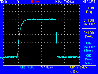

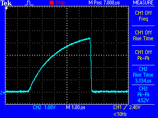

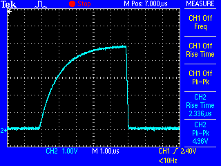

Nick gammon did some interesting measurements.
~50k
33k
10k
4.7k
2.2k
2.2K_pullup
1k
470 ohm
What exactly am I looking for here. I see faster rise times for lower resistance but what else am failing to see in this picture?
