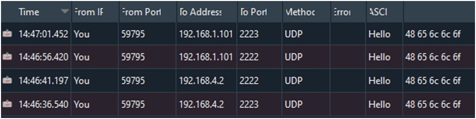

I am using “Packet Sender” to send "Hello" in a UDP packet.
In network connection mode, I sent a packet to 192.168.1.38 and 192.168.1.101 ports 2223 and 2222. Nothing showed up on the Serial Monitor
In standalone server mode, I sent packets to 192.168.4.2 and 192.168.1.101 ports 2223 and 2222. No luck.
Let me state that I know almost nothing about UDP communications. The Packet server is something I found when Googling “monitor UDP Packets”.
Not sure what is wrong. It may be as simple as the way I am trying to read/write in the loop().
Two questions:
  1. Why doesn’t the sketch display the packets that it is sent?
  2. Is Packet Sender a good tool to use for monitoring the UDP packets? It seems to send packets but it has never shown an incoming packet.

i'm not familiar with your use of "AT" commands. i have code (below) that send/receives broadcast UDP packets.
before any packets can be transmitted, the device much connect to the WiFi router using ssid/password. i only see the credentials used in one of you programs and am not sure if the are used properly.
this code has evolved over time, initially attempting to use TCP packet and have multiple sets of credentials that are matched against multiple routers (i.e. _wifiScan())
the following is state driven where wifiMonitor() is called within loop(). it checks for an ssid, then registers with the router, waits for it to connect and then monitors, listens for packets
