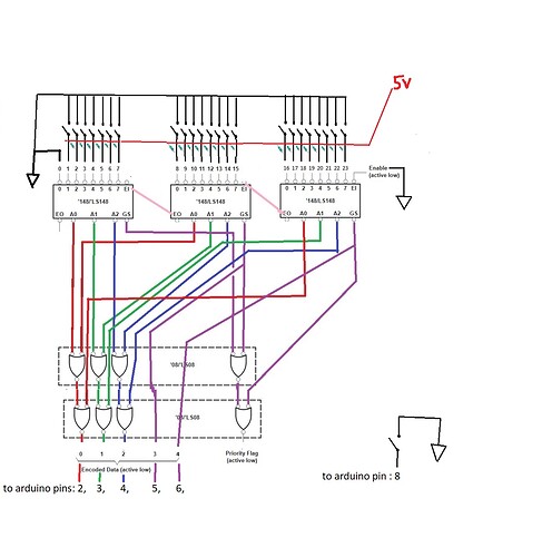

I have 3 of these chained together and thus have 5 outputs from the encoders:
A0, A1, A2, GS of the second ls148 and GS of the third ls148
I have switches to ground on all the inputs of the encoders.
I am trying to build a midi controller that uses one single button (on pin 8 in my code) to trigger midi notes with the note number being determined by the output of the encoders. the switches on the encoder inputs should determine the note number.
EDIT -- Ultimately I would like to know how to make each encoder input (1-23) both select the midi note number AND trigger the note on /note off messages. Also a button on pin 8 should retrigger (apply note on) the last note number sent.

Can you post a schematic please, and while your at it modify that first post so the code is posted correctly as you read in the how to use this forum sticky sticky post, that you read before you posted anything. Didn’t you?
Look at the application example for chaining two 74148 and extend it for three chips. Extend your circuit as required and adjust your code accordingly.
Thanks for the reply Grumpy_Mike, I have amended the post and added a rather crude schematic.

Ok you should really have posted those images as per instructions not on an external site.
You are using a 74LS device and are switching the input to 5V with a pull down resistor. That way of doing things doesn’t work unless the pull downs are very low, like 330R. You should have a pull up to 5V of 4K7 and switch the inputs to ground. Each chip needs a 0.1uF ceramic capacitor across its power and ground pins.
Edit - sorry you are using pull up resistors, it was the way you drew the schematic that had me confused.
Being a newb I dont quite understand your suggestion.
What he is saying is throw away all that circuitry and just connect the switches direct to the Arduino inputs. That means you switch say 5 inputs ( giving you 32 combinations of up and down) and in a binary pattern and convert that into a decimal number by software.

I think your circuit is a bit suspect. You do know that the way those encoders work is that they will only take notice of the highest number input that is connected low, ignoring all the other switches. Is that what you want?
Thanks Mike, I appreciate the help
I am aware the encoder takes the highest input, It is needed. I am not using the priority flags currently.

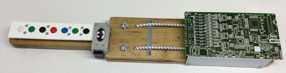

The concept is a one stringed midi bass guitar using the frets and strings as contact switches. The encoder inputs are wired to the frets of the guitar and the bass string is grounded.

Your circuit is okay. You can remove the Gnd on input 0 of the first 74148 and use its EO instead of the switch on pin 8. Or on another pin, if you want further functionality on the pin 8 switch. For the pin weights learn a bit more about the binary number composition from bits.

I did make a two stringed bass using bungy chord, and opto slot switches to detect its vibration. Then sent MIDI out depending on what button was last pressed. I work with Drake Music North, a group of volunteers who make and adapt instruments for disabled people.
I called this a Bat Bass, because the piece of oak floor board looked like a cricket bat. ( double pun ).
Thanks again for your help Mike, your work looks amazing. Fulfilling no doubt also :slight_smile:
I tried the code (both versions of "readInput") and can't seem to get a result in the serial monitor at all.
I feel as though I missing something simple...
Also, I couldn't find mention of 0.1uF ceramic capacitor across power and ground. Is this assumed knowledge?
Cheers

bryanfury:
I tried the code you provided but am getting incorrect values. Some inputs will return a certain value and after a few or sometimes many button presses will then output another value.
I just copied your code, it was just a demonstration of how to use banks. If you get incorrect results, then it's probably a mistake in either the wiring or the logic in the if-statements to determine the value of "val".
bryanfury:
The other issue is I require these inputs to trigger the midi notes without pressing the button. The button is used to retrigger the last input value. I intend to have the open string note of the guitar to be triggered with the button only.
In that case, it's probably easier to just call Control_Surface.sendNoteOn(...) manually, without using the Digital/NoteButton classes.
Thanks Pieter
I need to troubleshoot some more. I appreciate the help
Success, I had a wire go loose on the veroboard wiring...
Pieter, your code works fine, thank you. I don't know how to implement the "Control_Surface.sendNoteOn(...)" suggestion, can you please elaborate or provide a small example?
Thanks again
Yes.
I wrote about it here
http://www.thebox.myzen.co.uk/Tutorial/De-coupling.html
bryanfury:
In the code I posted earlier, the "NoteButton" class sends MIDI messages when the button is pressed or released. You can see a simplified version of how it works here. If the code is overwhelming, you can just focus on the "MyNoteButton::update()" function: when the button is pressed, it sends a Note On message, when it's released, it sends a Note Off message.
If you want MIDI messages to be sent when the values of the priority encoder change, you'll have to write your own logic and code to send these messages.

I have attached the output of the "priority flag" to pin 8, thus sending out midi note on messages when an encoder input is grounded and note off when the "button" is let go of. The only problem remaining is that if I ground an input then move to another input without lifting off/letting go of the "button", no midi messages are sent.
Is there a way to implementing this with the current code?
I am also exploring manually sending the messages as was suggested but am struggling with the logic to account for playing the notes but also checking if the new note is the same as previous note (and to not retrigger it)
bryanfury:
I don't know enough about the priority encoder you're using to answer that question.
Even if it's possible, writing your own logic in software will be much more flexible.
