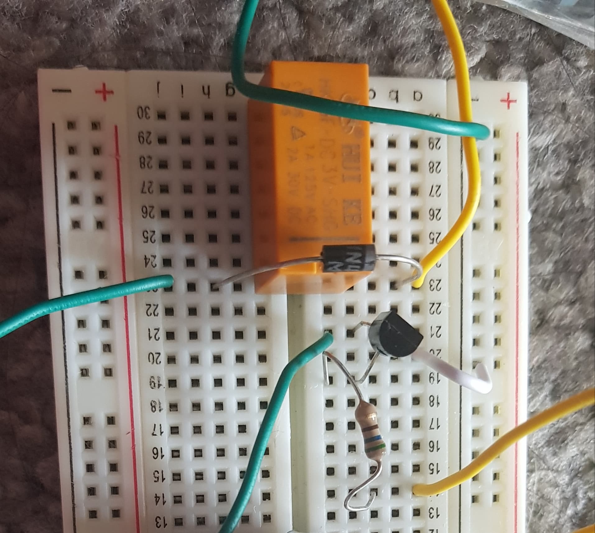

It is at the side of the diode - I don't think you can see it in the diagram since the diode covers it.

I'll add a picture of my wiring in case I've missed something.
The yellow wire is connected to the positive terminal of the battery and the green to the negative terminal.
The large green wire which is cut out from the screen is the same wire.

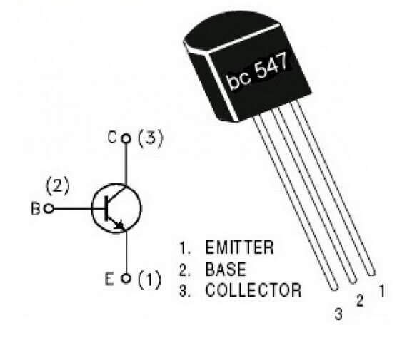

Looks like the transistoe may be backwards.
Can't tell if it's corrent since there are two yellow and three green
I didn't think it was because it can connect to pin 2 to toggle an LED without a problem.
The top yellow wire is the positive terminal, top green is negative terminal.
The bottom green wire connects from the collector to the diode and the bottom yellow wire is from pin 2 of the Arduino
It's backwards.
Just curious since it seems that I have switched the emitter and collector around - how is it possible that this has worked with the LED?
You would have to show me exactly how you had it connected when you made that test.
I connected it the wrong way with the collector to GND and the emitter to the resistor and LED and it worked, which is why I thought that it was correct.
I have switched it around now and it also works with an LED, so that's most probably my mistake.
