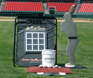

I googled "baseball pitching target" and I got this:
I got this because It's a perfect example of what you can build, you need arduino which gonna read
a matrix table, the ball gonna hit a square and it gonna be saved in a sd card which square did you hit.
You will need to make a "capacity matrix buttons" I call them like that, if the ball hit one of the square
the square will read that something pushed the front and back layer and the resistance going crazy :smiley:
so that means it's "pushed" so that data will be saved on your SD Card as hit.
