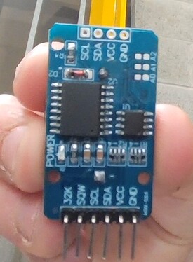

HI, I'm trying to implement uRTClib and RTClib together as i am using the TM1673 with the DS3231(with temp)
HI, I'm trying to implement uRTClib and RTClib together as i am using the TM1673 with the DS3231(with temp), im also tying to use the temp variable in with the DS3231, the code is as following:

What does the code do now? What does the code NOT do now? What will having the two libraries in one sketch allow you to accomplish?
Please explain why you believe that because you are using the TM1673 with the DS3231(with temp) you need to implement uRTClib and RTClib together. Maybe you have a valid reason, maybe it's just some misconception.
im creating a sort of lighting, heating system with relays, and the code doesnt work if i put them together, errors pop up "conflicting" anyway here is the code together

The short answer:
Try rtc.getTemperature() instead of rtc.temp(). If it results in compiler errors, tell us which RTClib you're using.
The longer answer how to approach:
The RTClib consists of a few files. Open the RTClib.h file (that is the one that you include) that is part of the library with a text editor and check the available public methods (functions) and members of the class that you use (RTC_DS3231).

Right... but why do you need the two RTC libraries?
i need temperature, one does the temperatue while the other doesnt, i am also using the tm1637
ill try
thanks so much
