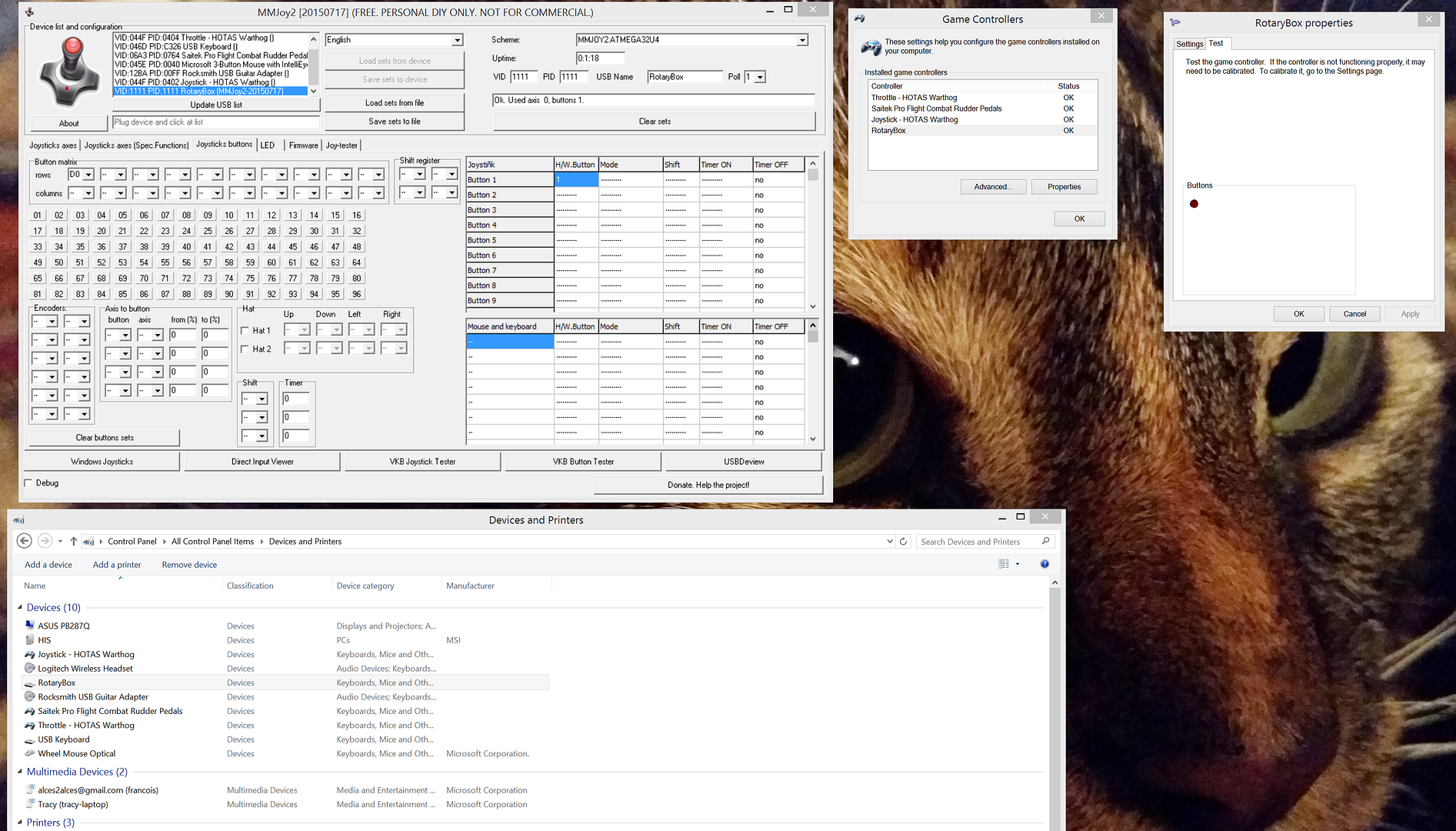

If anyone is curious how I am trying to attempt this, I am doing it first with a Leonardo and breadboard and once I figure out how to do that I will use a Pro Micro and do some soldering work.
The software is MMJoy2 which allows you to flash a firmware that presents the device as a game controller. From here you can program buttons, encoders, axes, etc.
Here's a view of the software and a Leonardo configured to look like a game controller.
I just have it set up as a single button controller at the moment as the breadboard, wires, resistors, capacitors, etc. are in a second package I'll probably get tomorrow, so maybe over the weekend I can get it working as a prototype.
( http://i1156.photobucket.com/albums/p562/xaoslaad/mmjoy2_zpstfnjxm47.png to see the larger version)

I've got it more or less working with one rotary. Adding more should be no problem. I'm going to start doing some of the soldering so I can clean up once some additional parts get here.
This SimHQ post shows that I should have diodes in place, which I have not received yet. So for now it only work OK if I turn the knob at a steady and deliberate pace.
The software also lets you optionally configure a button to re-center the access.
