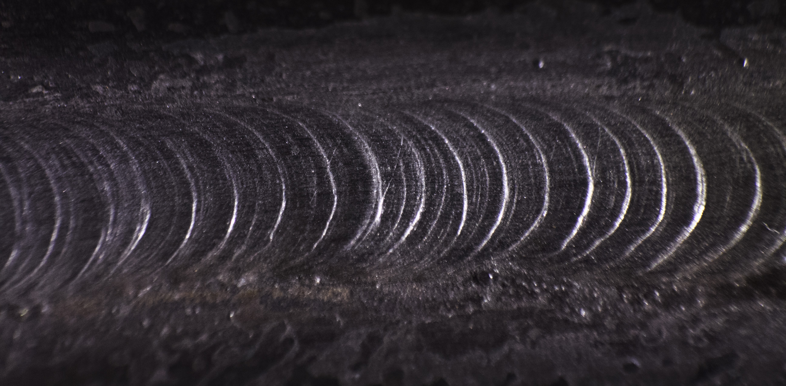

Attached macro photo of a weld bead run on plain old mild steel which I see as a partial win for this project.
