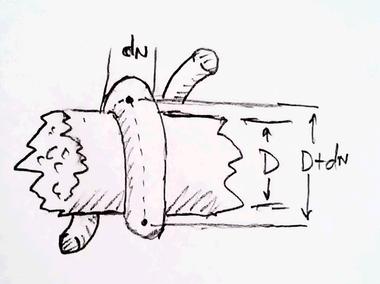

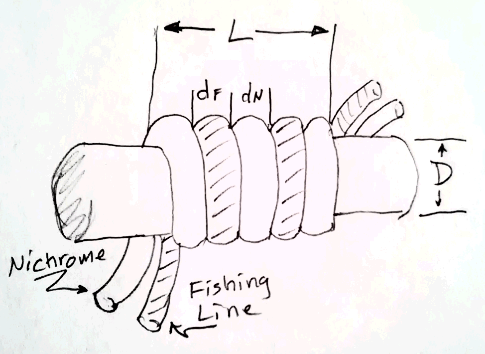

Maybe Nichrome wound on a plastic or wooden dowel to increase the resistance per length? With an adjacent winding of fishing line to prevent the nichrome windings from shorting together:
This would effectively lengthen the wire, imparting more resistance in a shorter overall length:
L = n(dF + dN)
Where:
  • L is the Length of the coil of Nichrome and Fishing Line (essentially the length of the sensor)
  • n is the number of turns. One "turn" would be composed of both a loop of Nichrome wire and a loop of Fishing Line.
  • dF is the diameter of the Fishing Line
  • dN is the diameter of the Nichrome Wire.
W = nπ(D + dN)
Where:
  • W is the length of the Nichrome Wire
  • n is the number of turns of Nichrome Wire (and, is actually the same value as before)
  • D is the diameter of the Dowel that the Nichrome and Fishing Line are to be wrapped around (essentially the core of the coil).
  • D + dN is the diameter of a loop of wire, from the center of the wire
W = 100R/ρ
Where:
  • W is the length of the Nichrome Wire in cm
  • R is the Resistance of that length
  • ρ is Ω/Meter
If we combine those these three formulas and solve for D, we get a tool for working out a Diameter for the dowel that will produce a sensor at the desired length:
100R/ρ = nπ(D + dN)
n = L/(dF + dN)
100R/ρ = (L/(dF + dN))π(D + dN) = **πL(D + dN)/****(dF + dN)**
Solving for D:
D = [100R(dF + dN)/(πρ****L)] - dN
Winding the thing might be a challenge. Might be easier with a lathe, but a hand drill might work or a drill press.
You might have to play with different values before you find the right balance. I like to use a spreadsheet for this.
And, everybody CHECK MY WORK!!!
