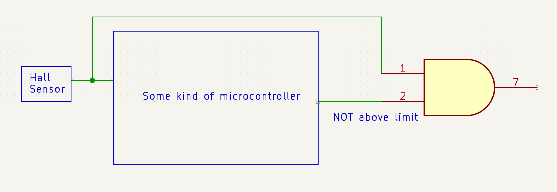

lets try again
there is a engine that uses a hall sensor to trigger the rpm
and I want the engine to behave as a hit and miss
so I tried using a script that can read the sensor and give me a rpm output
and I added a bit of code to put in a limit
and above that limit there is no output
and under the limit the sensor signal should be copied to the output pin
is this clearer?
Not really, I understand the overall view. Still need more to write the code.

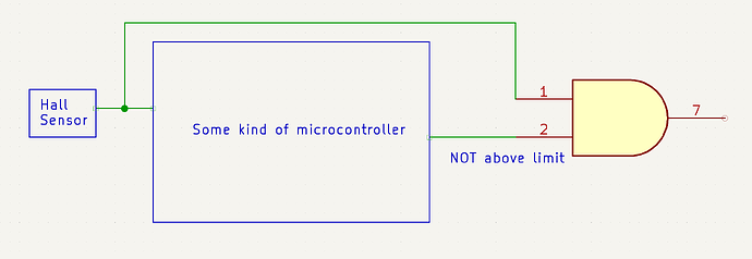

Does this diagram accurately explain it?
that looks about right

so if I get a way to output the pulse I am good
You need to use either an external logic gate, or an interrupt, nothing else is fast enough or consistent enough.

Try this, I tested with a pulse generator, and it seems to generate a reasonable output (as seen on oscilloscope).
It could be optimised a little more if necessary. However, I suspect it might need more sophisticated control techniques than a "bang-bang" approach (pun intended :slight_smile: )
