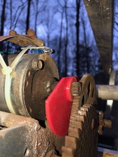

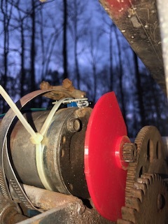

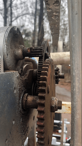

Not sure if it matters, but I am going to try again and attach the winch (that is geared way down) that I am planning to connect this to. I am planning to connect a 3d printed part to the main shaft (shaft of motor) the IR sensor will contact this 3D printed part once each revolution (I may increase if I need a higher resolution) The winch is geared down I;m guessing somewhere around 400:1. I am hoping this high number will allow fairly accurate precision.
This is on a sawmill. This will only be determining the width of cut of each board. They are rough cut boards. I don't need them to be accurate to the nearest .001. I have always used this winch by hand with a toggle switch, and I watch a ruler as I let it up/down to determine distance traveled. I'm guessing I probably get it accurate to 1/32nd (.03) of an inch maybe.
I am hoping this will be around that accurate or hopefully better than that. It may not be, and I may have to experiment with the sensor type to find the one that best suits my needs. I am just very appreciative of all of the members that are taking their time and helping walk me through this project. I am learning a lot (very slow sometimes) and hopefully will be able to use these basic coding skills I am learning for this and future projects! Thanks again for all of your help!
Thanks for the photos, that's helpful.
The IR sensor will work but is prone to dirt in that environment (fully exposed).
The magnet with hall effect sensor is a better solution indeed, not so easily affected by the dirt.
Now looking at this photo there's yet another possible sensor: the inductive sensor, which can detect teeth passing by. You can use that to basically turn a gear wheel into an encoder. That gives you an even higher resolution.
I'm quite sure that by counting single rotations of the shaft you will get to the best possible positioning with this system. The difference in height due to things like play in the gears and stretch in the wires is likely way more than a single rotation.

The pictures are what I have in mind.... the code seems to be working with leds and I did connect it to the small motor driver chip I mentioned earlier and the small dc motor I have been testing with and it is working.
I really don’t know what R_Is, L_Is, R_En, and L_En that go to the motor driver are or if they are even necessary for my application??

What is the idea of that dangerously unbalanced disc?
I don't remember you telling us what motor driver you're going to use so it's hard to comment on pin assignments.
