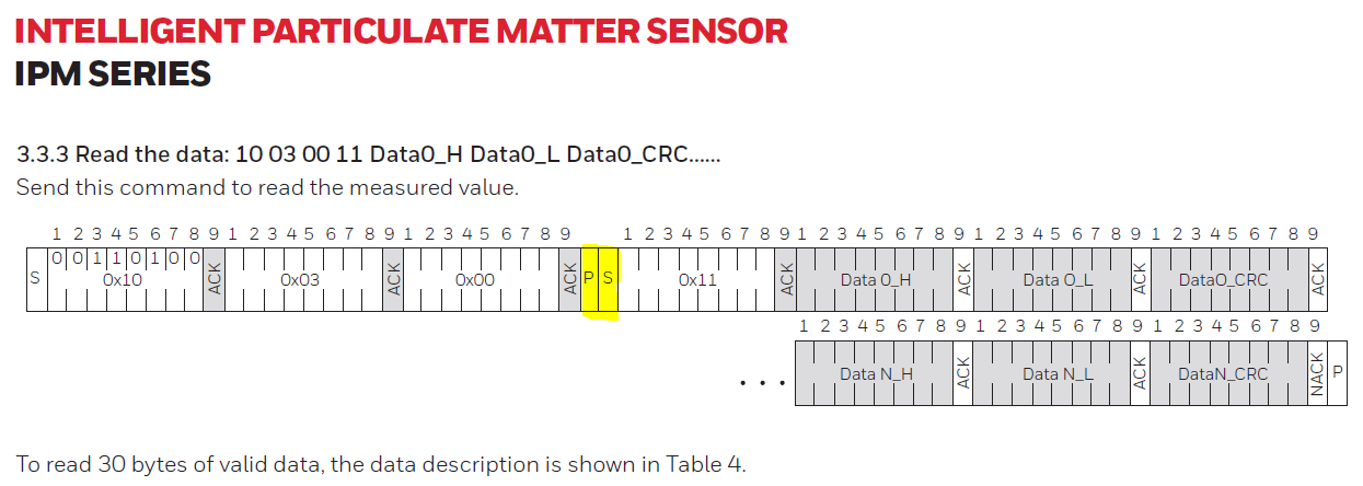

Oscilloscope is reading i2C Channel with 0x11 Read command.
asking
March 20, 2024, 6:12am
9
DSO Debug details
I2C, Time, Address, R/W, Data
1,-10.0140us,0x10,W,0x10 03 00
2,389.044us,0x10,W,0x11
3,1.60918ms,0x11,R,0xFF FF AC FF FF AC FF FF AC FF FF AC FF FF AC FF FF AC FF FF AC FF FF AC FF FF AC FF FF AC~A

so the CRC is correct!
just strange that all the pm data is 255(0xFF)...

the IH-PMC-002 datasheet says the returned data has the following format, prefixed with 0x10 0x03 0x00 0x11
10 03 00 11 Data0_H Data0_L Data0_CRC......
i don't believe you are reading the data correctly
no it doesn't.
you SEND those to get reply is what the datasheet says (see screenshot is reply #10 )
at least that's how I read it!
but yes, there could be a prefix of 0x11 though...

it says you send the following to start a measurement
3.3.1 Start measurement: 10 00 10 05 00 F6
and receive the following
3.3.3 Read the data: 10 03 00 11 Data0_H Data0_L Data0_CRC......

Correct.
I had only doubt regarding after reading datasheet thoroughly.
after 0x00 - ACK - P - S .
Do we need to user Wire.endTransmission(false); with false parameter ?
asking
March 20, 2024, 9:48am
19
Just below 3.3.3 its written.
Send this command to read the measured value.
was just about to point that out!
maybe try the code again from post #10 again and but comment out this line to see if that makes any difference:
byte command[] = {0x10, 0x03, 0x00}; //<------- change this command
Wire.beginTransmission(PMS_ADDRESS);
Wire.write(command, sizeof(command));
Wire.endTransmission(); // <----------------comment out this line
if you now see the 0x11 prefix then that would match the datasheet
then would need to adjust the code one more to compute the CRC correctly (all CRC with modded post #10 code should not match it what I expect)
no harm doing a bit of trial and error!
