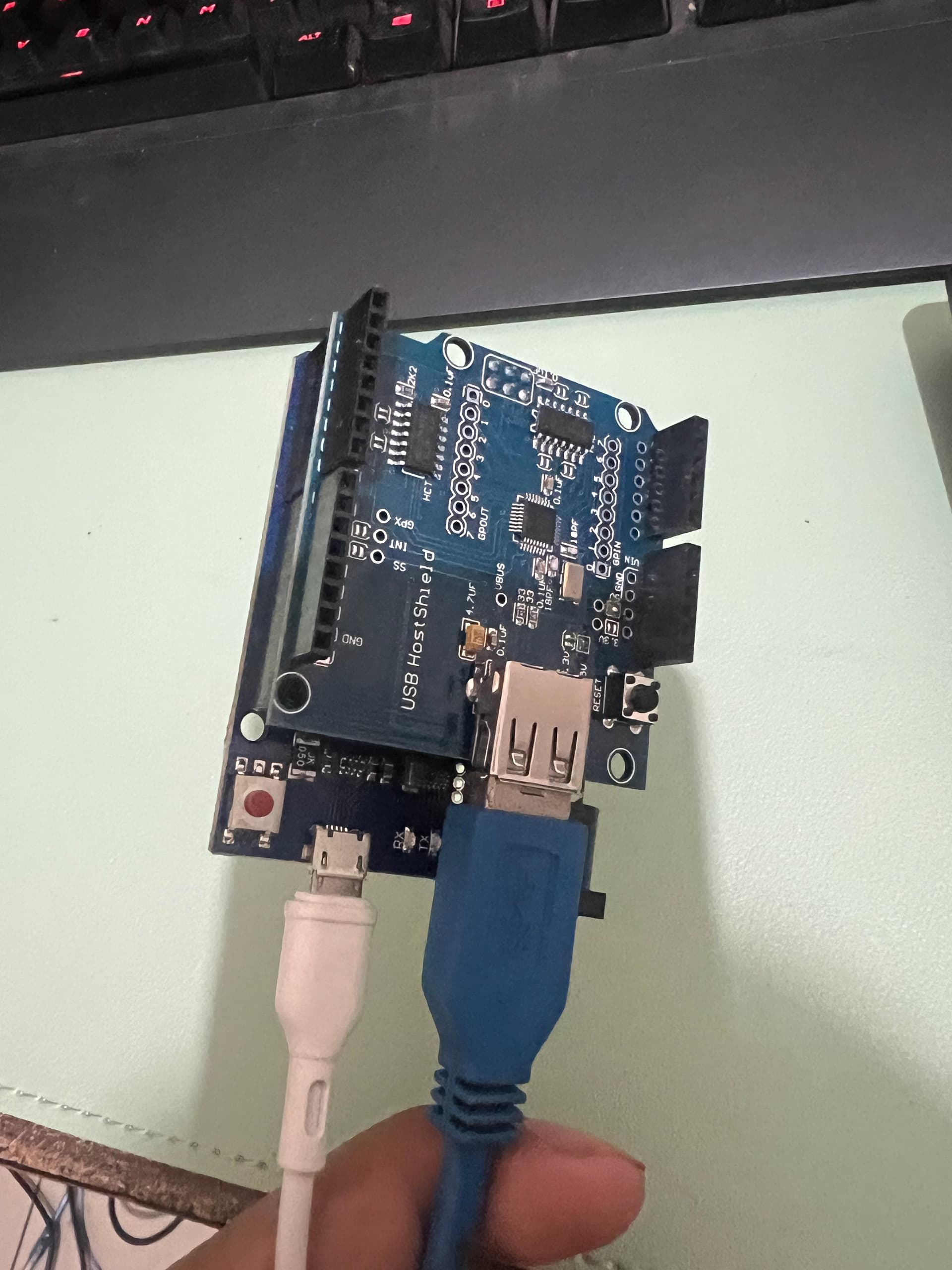

I would like to create project that can write/typing keyboard to PC B from my PC A with arduino real time.
The photo below shows an Arduino Leonardo + USB Host Shield. Can you create an Arduino project to emulate a keyboard?
  • The white micro USB cable is connected to Computer A to run the script.
  • The blue USB cable is connected to Computer B to emulate a keyboard (similar to a physical keyboard).
So, every time Computer A runs a script, for example, typing "Hello," Computer B should also type "Hello." I've tried several tutorials, but the output still goes to Computer A via the white cable, and the blue cable on the compyter B doesn't detect anything. Thank you.

I think you'd better share your code.

What sketch is running on the Arduino ?
updated with code
First of all, I just wanna know is that possible to make usb hostshield as Host output and act like a keyboard?
updated with my code
Which Arduino board are you using ?
already mention in my post, Arduino leonardo and usb host shield, is this detail not enough?
My apologies, I missed that
The Leo can certainly be used to emulate a keyboard. Does it do that OK with the shield disconnected ?
Hi, yes, Leo can emulate and run my script, but I want to use that usb port from leo to connect and run script from my PC A, so I need another usb port to send and emulate keyboard to PC B, thats why I use usb host shield, but it didnt work (not detected on PC B)
Years ago I made an 'Arduino messenger'. Two people could chat through the serial monitor of the Arduino IDE. I used two ARduinos on two sides. I configured two Bluetooth modules in Master-slave mode. I connected them with each of the Arduino. Will this solution solve your purpose?
