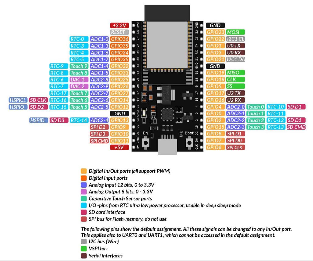

Dear All,
I got the ESP32 DEV Module C V4.
Learned how to upload a code in it. (Challenge... but managed.)
Looks like there are serials at pins 16,17, but also dedicated Rx, Tx.
Can anyone help me to adapt the code so it will work on this new unit?

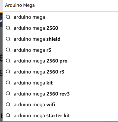

After struggling around with ESP32, I am back to your suggestion with Mega.
What would be the version?
Which one would support 115200 hardware serial?
No problem to buy, but I would prefer to be sure. Thanks.

whenever the microcontroller board is named "Mega" it has a microcontroller of type "Mega" In most cases it will be the Mega 2560.
And all of these boards have a second hardware-serial.
Hardware-serial can easily support 115200 baud. Because the receiving is done by a hardware-UART which works much faster than a software serial on an arduino UNOboard. The UNO has a rather slowly processor-clock of 16 MHz with 8 bit.

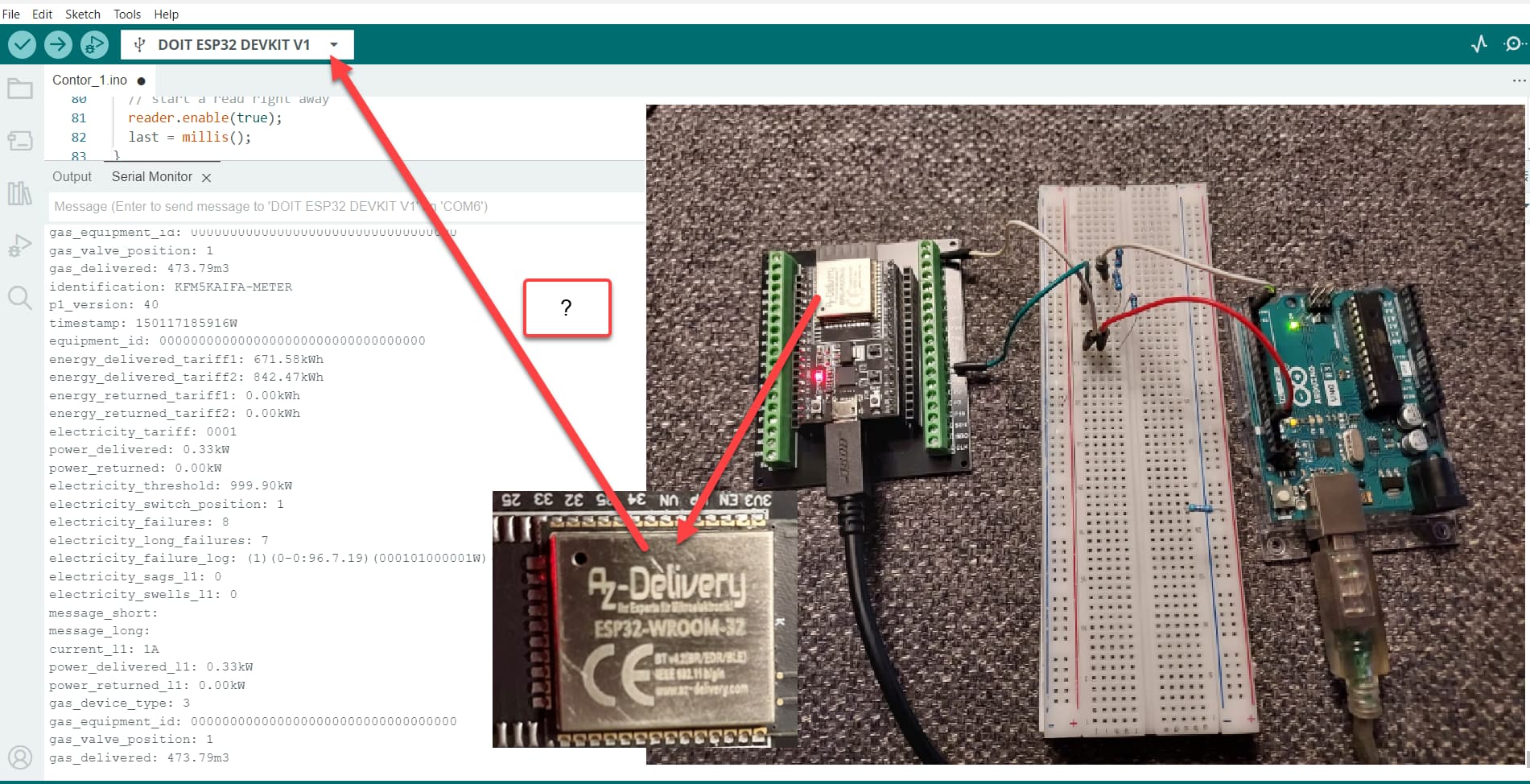

@viorel_c
Hi
As you now have both an Uno and ESP32, you can very easily emulate this project on your bench, with very few additional components
Using the setup above along with the example sketches that come with the library. Slightly modified, as here...
Upoad this to your Uno. Take care with your Tools board settings and COM port

Uno is now printing a simulated output of the Energy meter at 115200 buad on pin 1.
Upload this to your ESP32 again take care of Tools board settings.

Connect the devices as shown above. The resistors are forming a logic level voltage divider as Uno is a 5V device and ESP32 is 3.3V. Value of resistors not important as long as all the same, +1k Ohm range is fine.
With both devices plugged in and running on your computer, if you open the serial monitor for the COM port that ESP is using. You should see the parsed output every 5 seconds as below...

Edit: Pin 1 on Uno is TX to voltage divider
Pin 16 on ESP is Serial2 RX from voltage divider

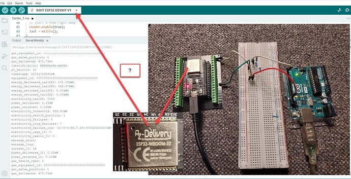

@indev2
Done, and indeed I get similar info as you.
(On the ESP32 I have is mentioned V4. Could not find it in library so I've selected Dev Kit V1)
Does it means now that if I change Uno with signal from energy meter, then I shall get my data? I will try it.

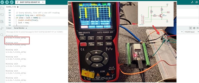

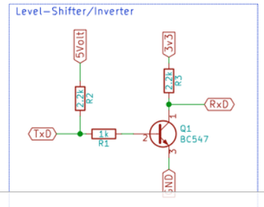

PS. You say that ESP32 is 3.3V. Correct. However, the one I have have 5V at the close left pin.
Well you can certainly try, there maybe problems with the inverted output, and do keep the voltage divider in circuit. How are you sending the output trigger?
Yes all esp's are 3.3V. The 5V pin is just a line out of the 5V usb in. And don't worry too much over the V4 designation, the default Dev Kit V1 is usually OK.

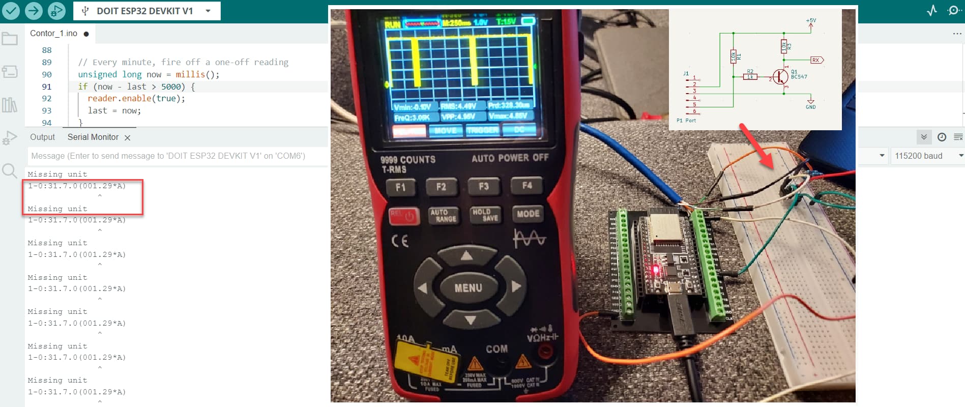

Meaning the 3 resistors you indicated? Even I have the inverter?
Checkmate! No clue what you mean. Sorry.
Without inverter, nothing. (I will try again this one with 3 resistors version.)
With inverter, something...

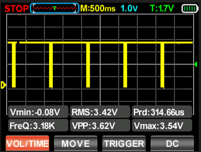

Do you need an export of the strings I get with Putty?
What strings are you getting in Putty?
Can you post a copy?

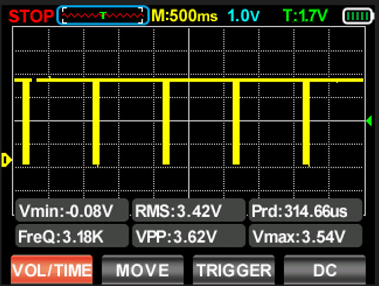

The inverter will be outputting 5V logic. The other option (schematic) you posted was for 3.3V. You can use your current inverter if you put the output through the 3 resistor divider.
This is what is coming out.
Tomorrow the divider with or without inverter.

@indev2 I've done the tests with or without divider. Direct or via inverter.
With divider, nothing.

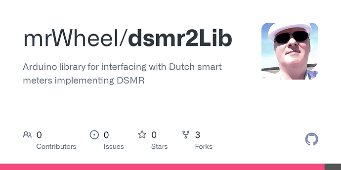

I would like to draw you attention to multiple energy meters reading libraries available on the web. Some of them general, some of them NL-BE, some of them BE.
As I have no clue how to understand and use these libraries, I just point out on these differences.
Here is for instance one example:
This one would have for instance dsmr2.h file, instead the one you used.
If I load / use these, instead dsmr.h you used, then I get compilation errors, which I have no clue how to deal with.

@StefanL38 What about asking to show how the measurement is at port 16 of ESP32?
That would be x10 positive approach.
Here it is. Would this give you the answers?
So, the 3.54V should not give any issue to ESP32... I assume.
I've applied diagram from post#76, so, 5V is applied to the energy meter, and 3.3 to BC547 to invert the signal. GND is commune.
I know you want to help, with open heart. So, please do.
