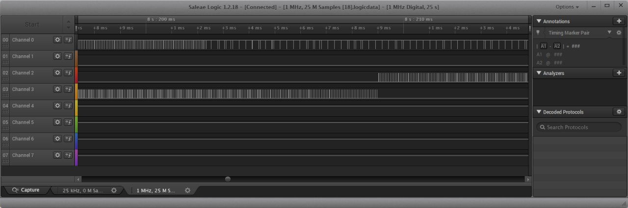

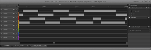

I want to add a digital speed readout to my car's traditional instrument cluster. And I'd rather avoid using GPS or sniffing the CAN bus, or worse, something like measuring ABS sensors directly, etc. Naturally, I thought it'd be feasible to re-interpret the speed stepper's waveform. That sounds safe and simple enough for me. Or at least it did until today.
So, I got a cheap instrument cluster to experiment with. It has 4-wire (bipolar?) steppers similar to those that my actual car's cluster has. I see no separate driver ICs, all lines go straight from the cluster's CPU.
Now, the problem is that upon closer inspection, the waveform looks kinda PWM-ish with a frequency of around 15 kHz.
When I zoom out, I see the expected steps, but they appear solid because of PWM.
Each step has duty cycle rising from 0% to 100% and then falling to 0%.
I've also attached a capture from Saleae Logic.

If you are posting a picture of the voltage at the coils of the stepper motor then what you are seeing is the sequence of pulses needed to make the motor move. When the motor gets to the desired position the pulsing should stop.
I'm not sure whether it would be practical to interpret those pulses to determine the value displayed by the needle of the instrument. You would have to detect (at vehicle startup) when the motor is moved to the ZERO or HOME position and from then on keep accurate count of the motor-steps up and down.
Note, also, that the position of the motor only represents speed because the drivers eyes see the speed-number that the needle is pointing at.

Think you have the wrong idea about how steppers are driven.
The signals are only present when the stepper has to move, making it move in a direction and certain number of steps.
The air-cored automotive steppers that you want to monitor are not driven by the normal standard step, step, step pulses but PWM signals to produce the smooth analog meter type characteristic.
Interpreting those signals would not be feasible.

I used its test mode (power up while holding the reset button), so the gauge (all gauges, actually) went back and forth three times before settling at zero.
Okay, so did the trace stop showing pulses when the gauges settled at zero?
It may do because it is zero, but I would say if the gauge was showing a constant reading other than zero, you would be seeing pulse signals all the time.
Tom... :slight_smile:
It kept showing pulses even after the gauge had settled at zero. In this case I guess the zero is no special from a positive constant requiring "pulse signals all the time".
