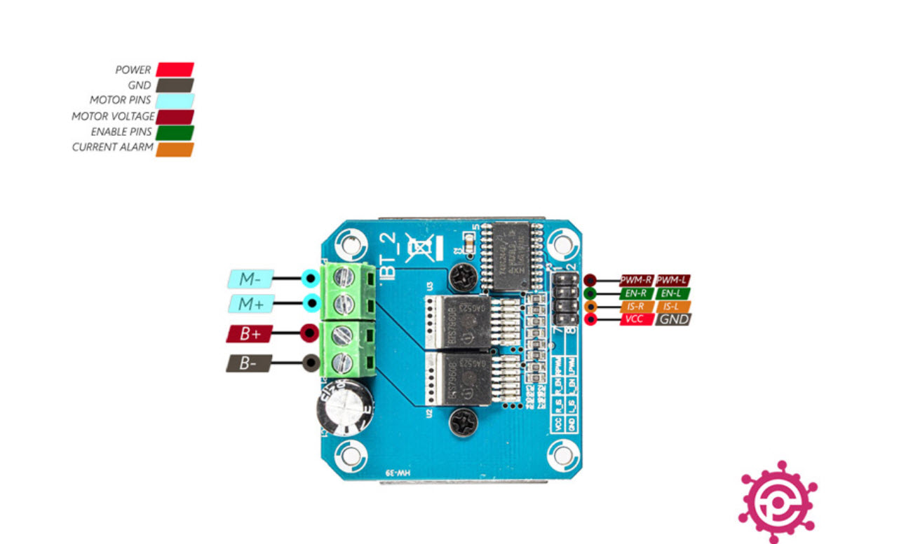

Then it´s time for you to tell us which motor driver you do have and show a schematic of how are all the things connected.
#define RPWM 5
#define LPWM 6
#define REN 8
#define LEN 9
If by REN and LEN you mean Right Enable and Left Enable, this suggests that you may be confusing the pins of your driver. On a L293N, for example, you need 3 pins to control 1 motor. 2 inputs (common digital pins) and 1 enable (PWM).
Reverse direction is just changing InputX HIGH / inputY LOW to InputX LOW / inputY HIGH
this is my motor driver
Looks like a BTS7960. In this case, pins assignment in the code seems to be ok. You didn´t provide the schematics though.
