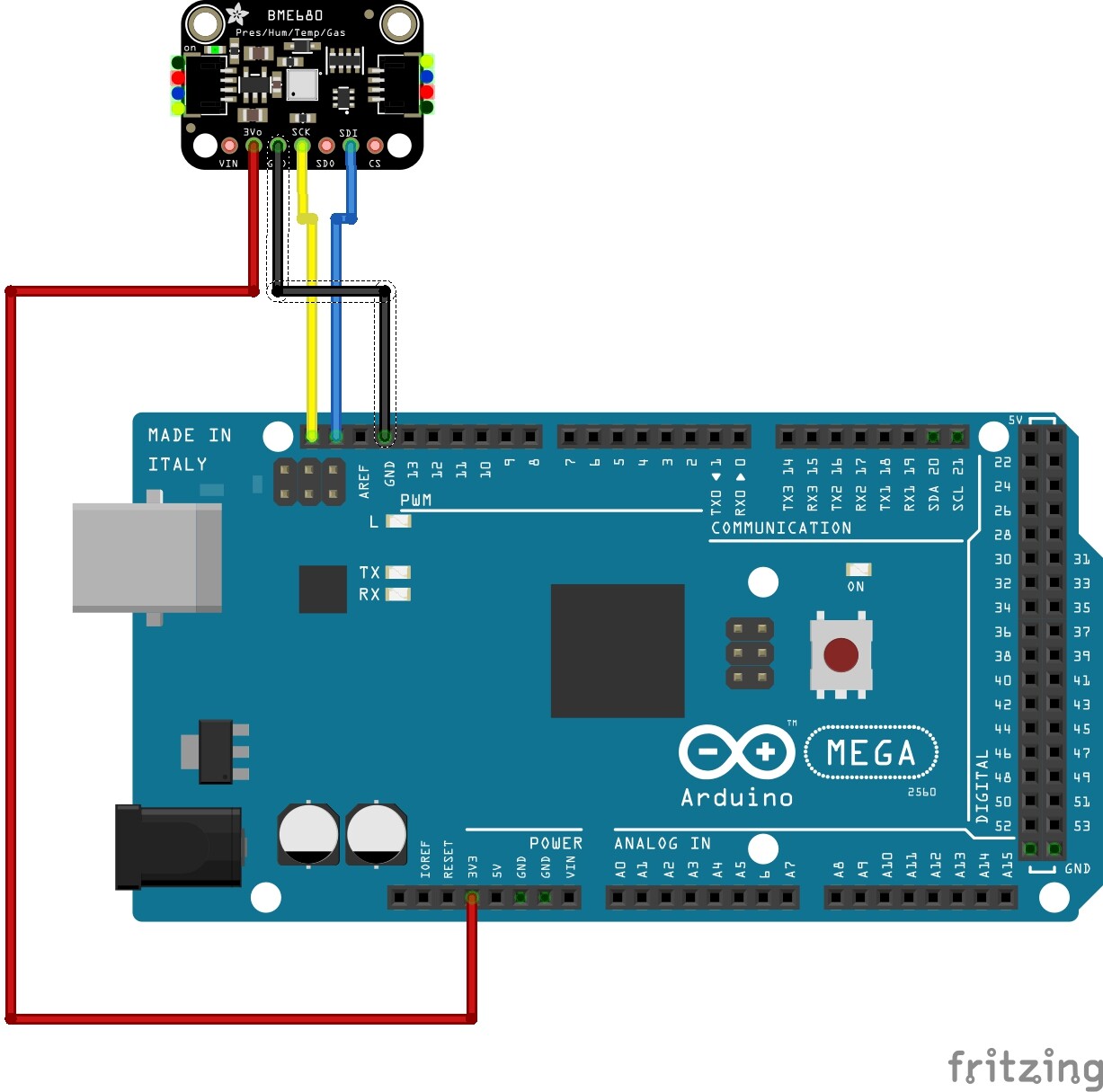

This code is jamming on the tab "Home", line #34. It goes off into the weather tab and starts hanging and jamming and nothing changes when it's supposed to. So far all I've done is polling, however after trying to fix it for days it isn't working, and I don't understand how to get rid of the delay in the Zambretti code in the weather tab while also checking if six other things have changed or not.

Post a schematic as you have it wired including all ground and power connections. Also include the power supply(s). Also post links to technical information on all the hardware parts. It appears you are either supper programer to get that much code in less than I am assuming 7 days a week for 8 years. Studies have shown that the average programmer in a production environment puts out about 10 lines of code per day.

The Touch screen backpacks on to the double headers, and the datalogging shield connects as they always do.
http://www.lcdwiki.com/3.95inch_Arduino_Display-Mega2560
https://www.ebay.com.au/itm/255534295635
https://docs.arduino.cc/hardware/mega-2560
https://www.ebay.com.au/itm/394009225518

A bunch of nice but useless pictures the same as the frizzy picture. I asked for a schematic as you have it wired including all ground and power connections. Also include the power supply(s). Also post links to technical information on all the hardware parts. The link to the LCD is OK. To fix move wire 3 to, the yellow one from, the orange is, you get the idea!

Ok. That's great. But I do not have a way to make a schematic. If you can donate some of the expensive software to create this schematic, I will be able to draw one. Otherwise, a wiring diagram will have to suffice. For most people, it isn't hard to see how a shield connects to a board - they line up and drop on. Also, I do not have datasheets for all of my modules, as most of the datasheets for them are written in chinese. If you can read chinese, you will have to find them yourself, as I can't read chinese.
